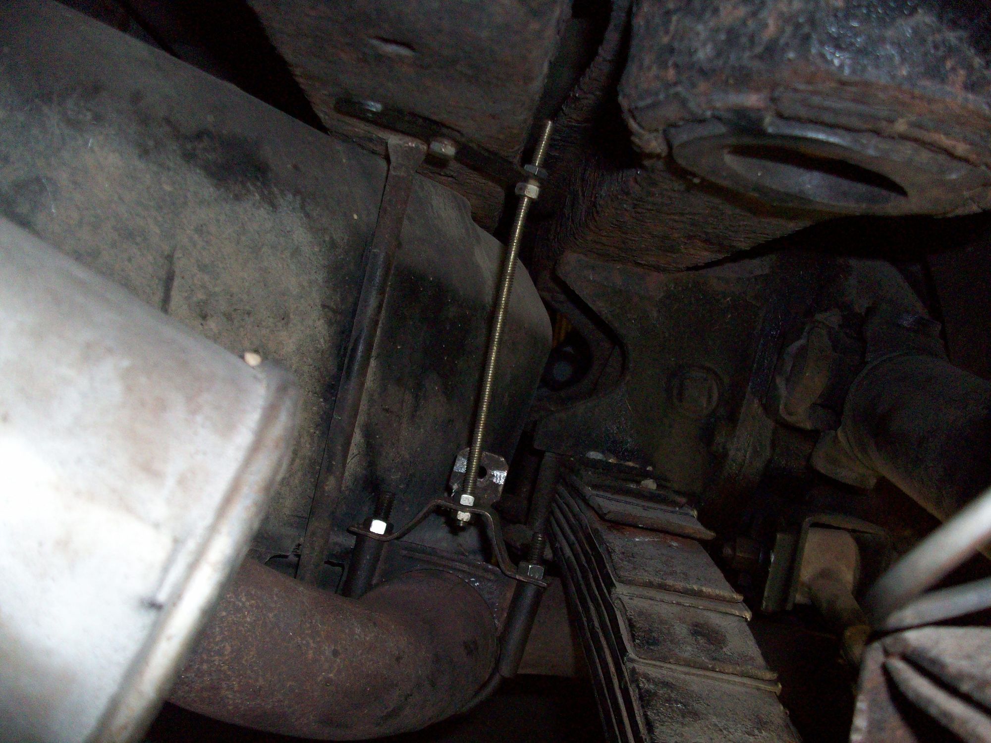

I then turned my thoughts to the exhaust system. The driver’s side pipe had once again sagged down as a few had noted - thanks. Taking lessons lessons from Jim, I added BUBBA hangers at the elbow behind the rear spring. I didn’t want to drill or modify the frame or anything, so used HOARDED JUNK I had laying around to attach the hanger to the frame. I pulled the pipes to within 1/2” of the spring. If this works, I will probably buy the aftermarket hangers to make it look more PRO.
