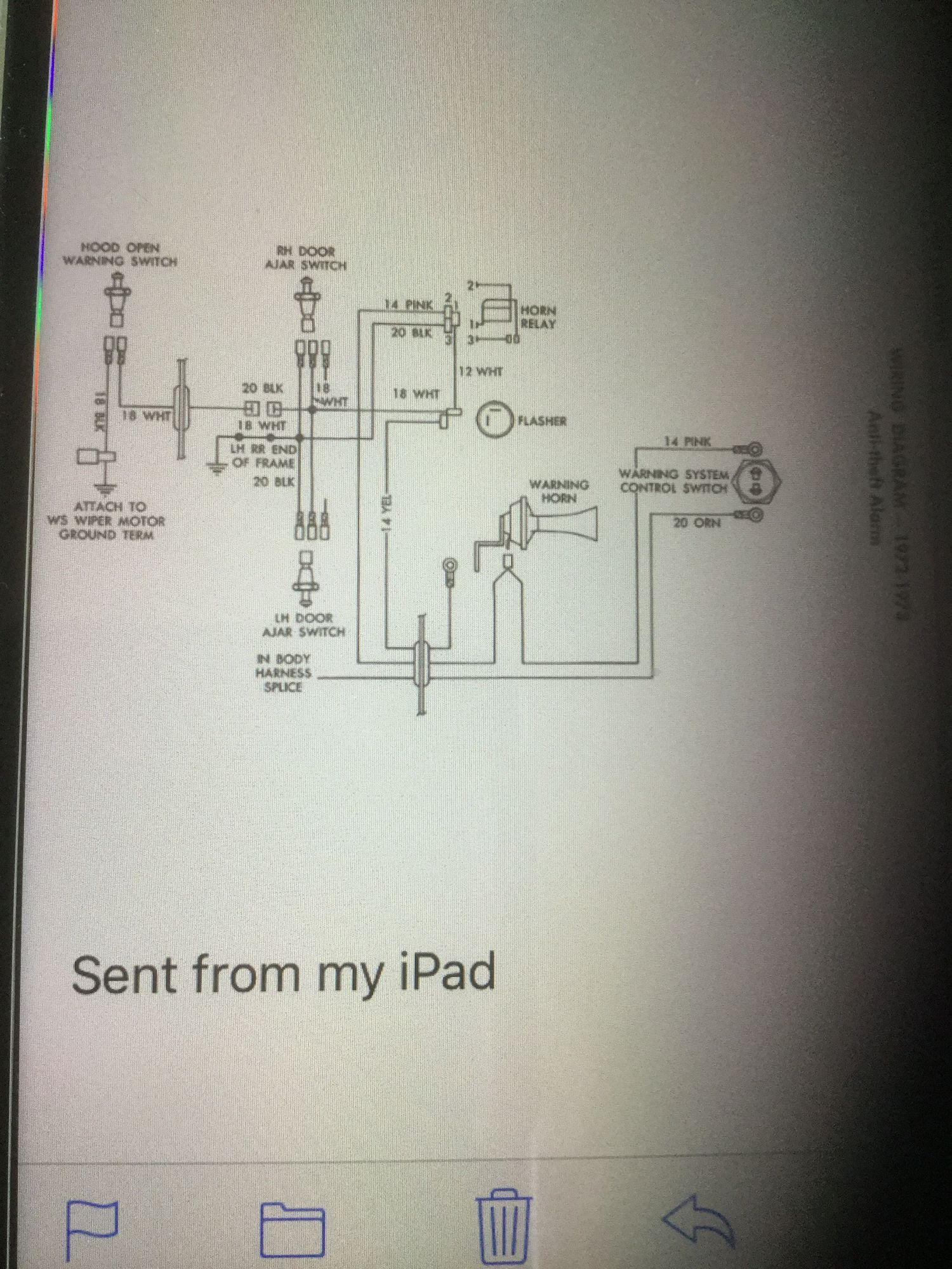

You need to read the 12 volts from the orange wire and it goes to the key switch. You could read the orange positive at the key switch and the pink at the realy
