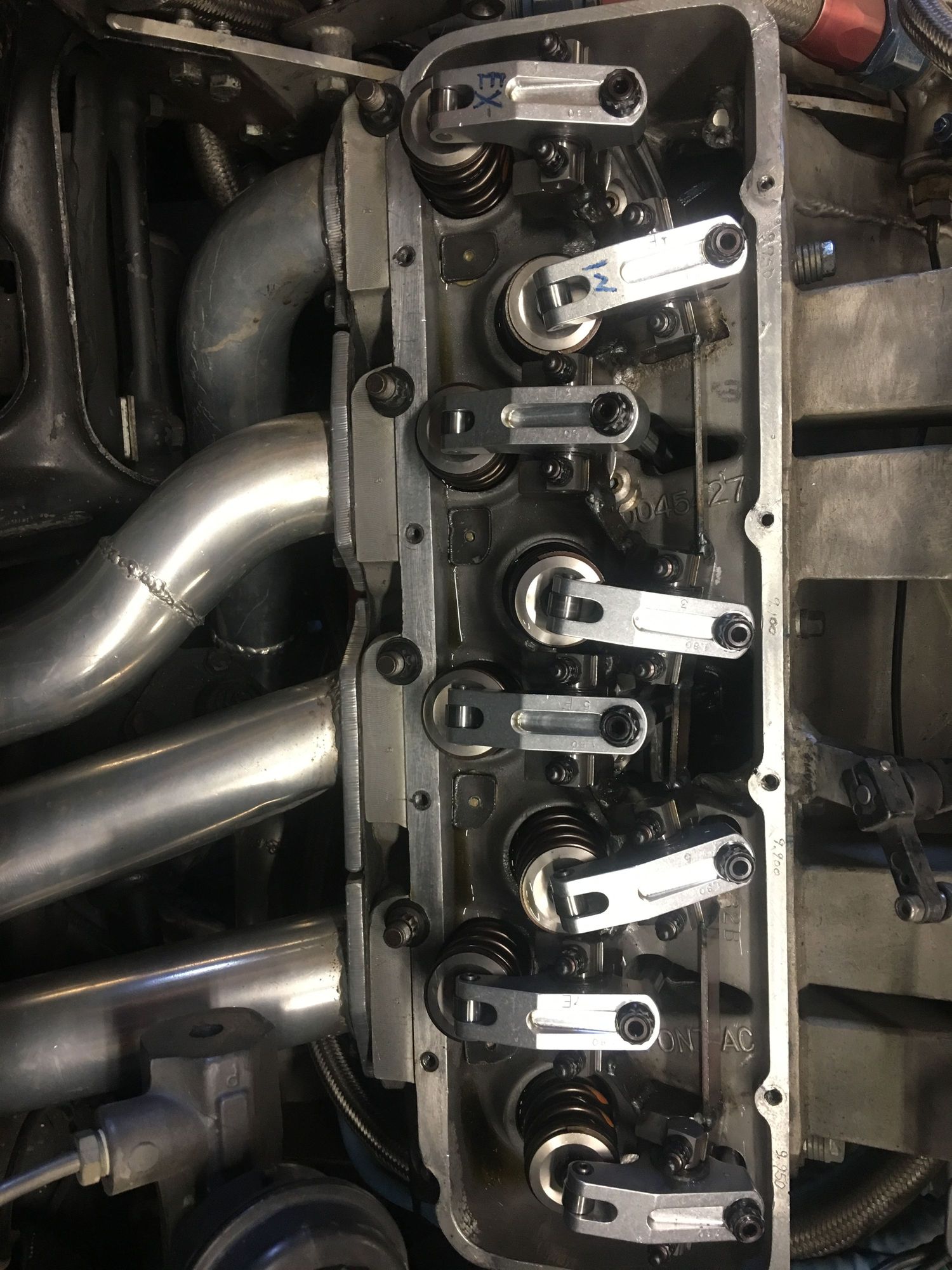

T&D did the rockers,and rocker stands, then I made the tie bars, and welded all of the stands together so they are one solid piece, and won’t pull out of the heads with 350 plus on the seats, and around 1100 pounds open with a 9200 rpm shift point
