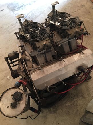

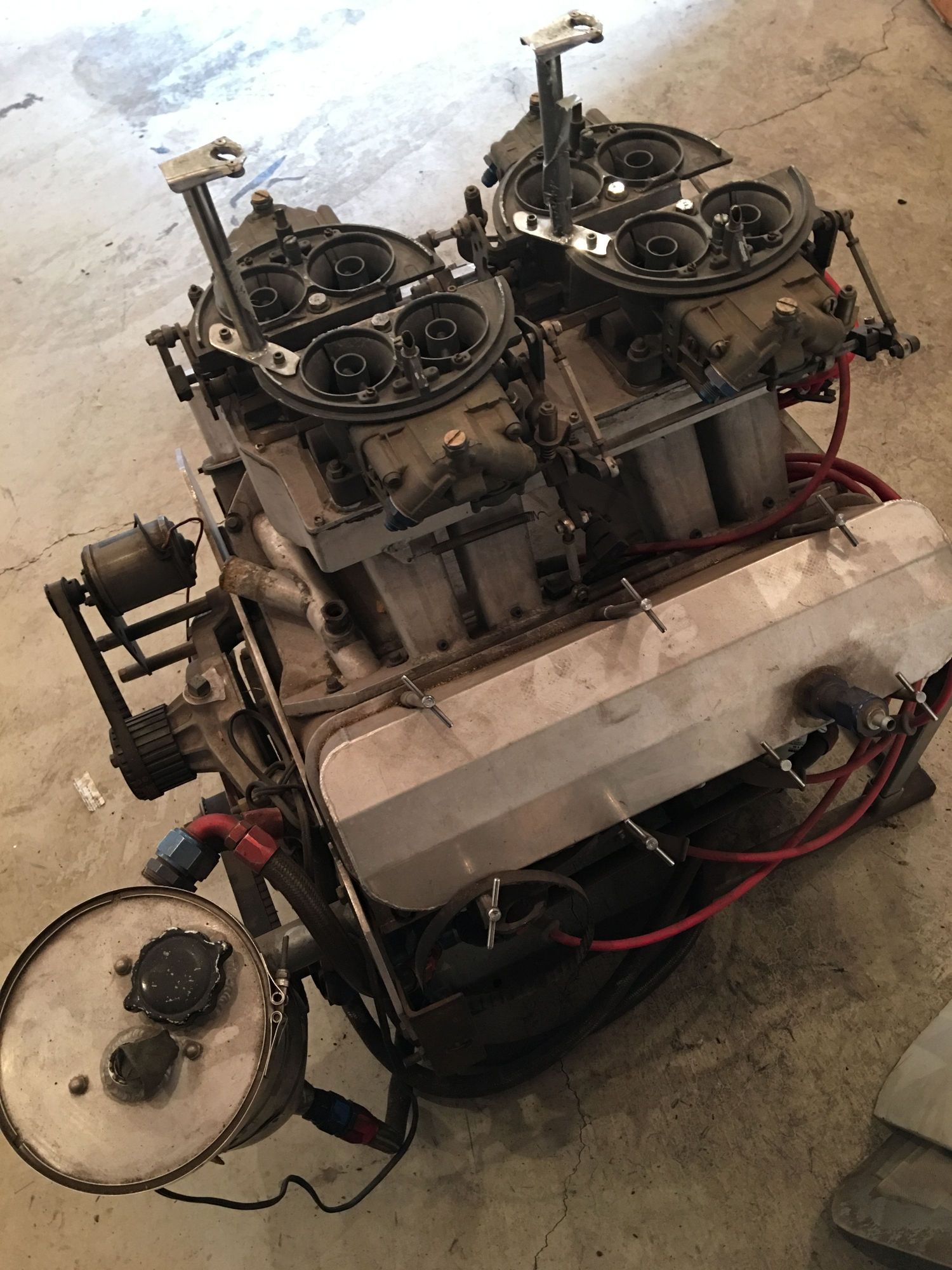

Some pictures of my younger years heavily involved with other serious gear heads. I built this 4.500 bore 3.5” stroke (I think it was around 445 cubic inches)big block with seriously modified 24 degree heads 17 to1 compression, dry sump, sheet metal intake, split dominators before you could buy them that way (it took me about a week to figure out and build the throttle linkage)that made 980 horsepower
