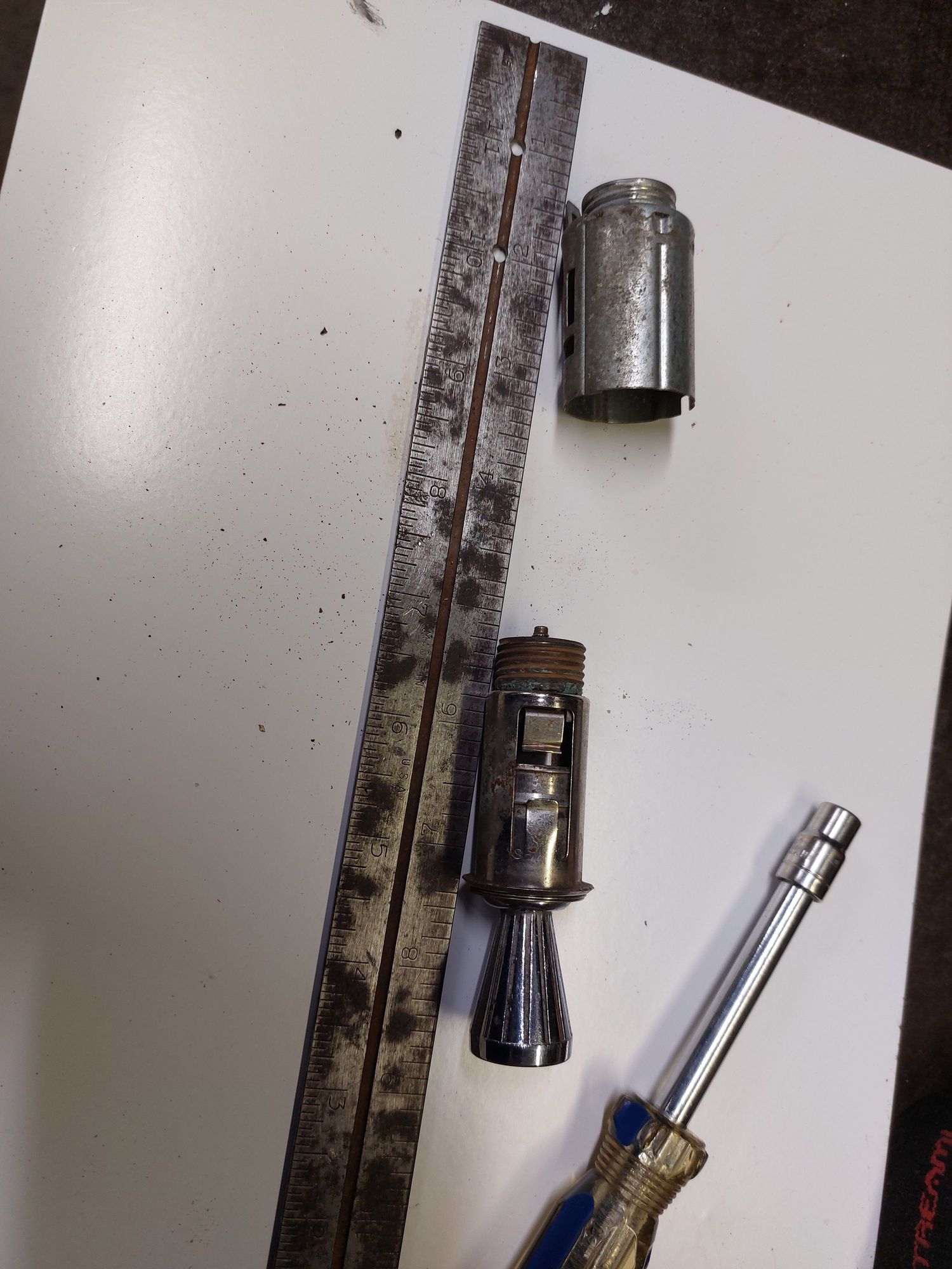

Pay close attention to the tabs on the U-shaped contact inside the housing during reassembly, it must align with the slots in the housing.
