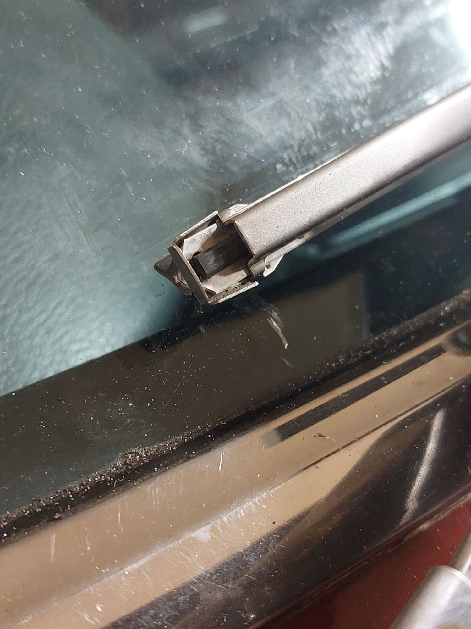

To remove the refill, squeeze the lock on the bottom end of the wiper arm assembly. Then you pull the refill out from the 4 locations with tabs to hold it in place.
