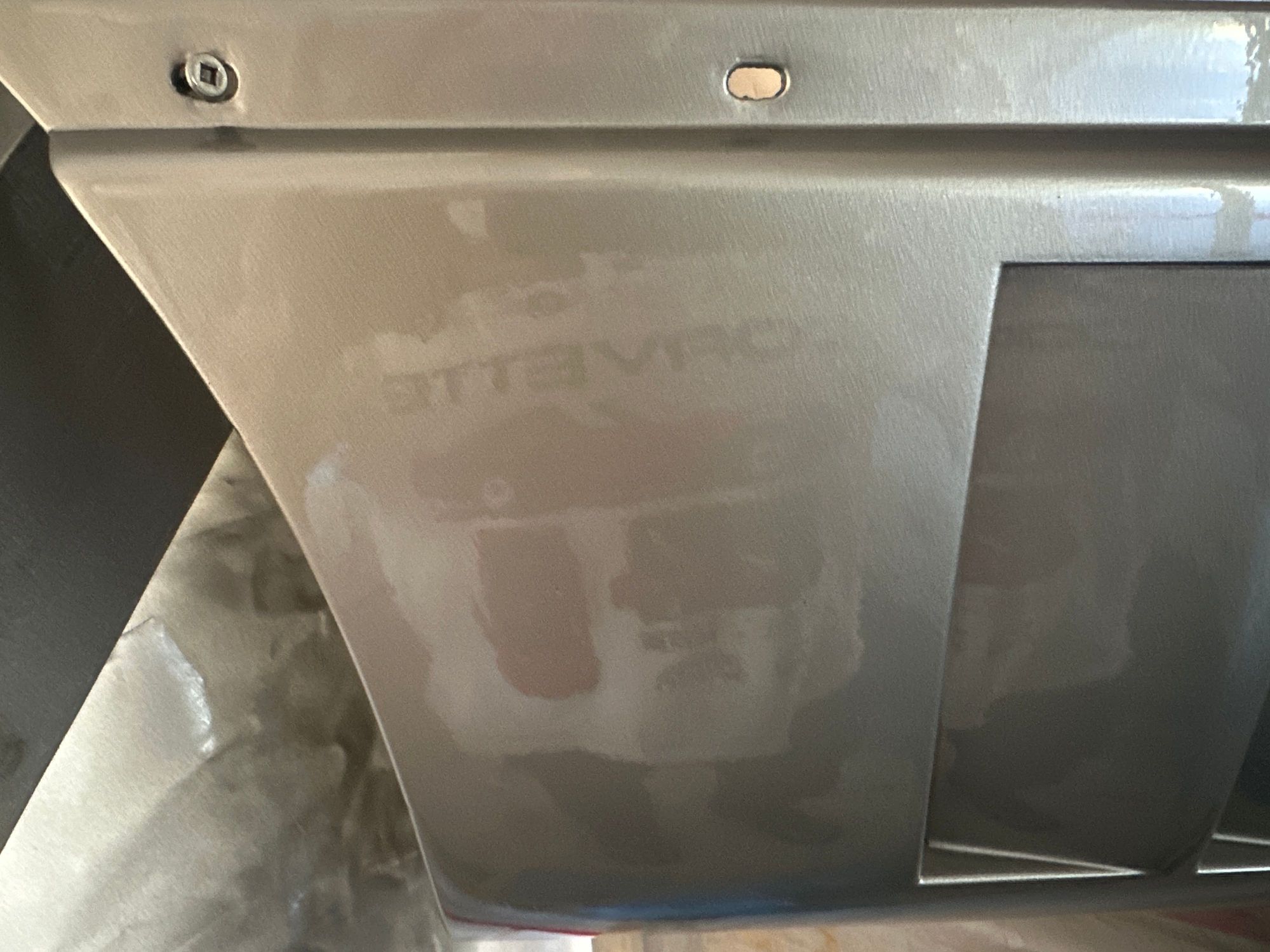

This was a test from a few days before. There is orangepeel in the primer that came through up to the clear but i fixed that and the primer is laying flat now. i had to go to a 1.4 tip from a 1.7 because i thinned it so much. the clear will wetsand down.
