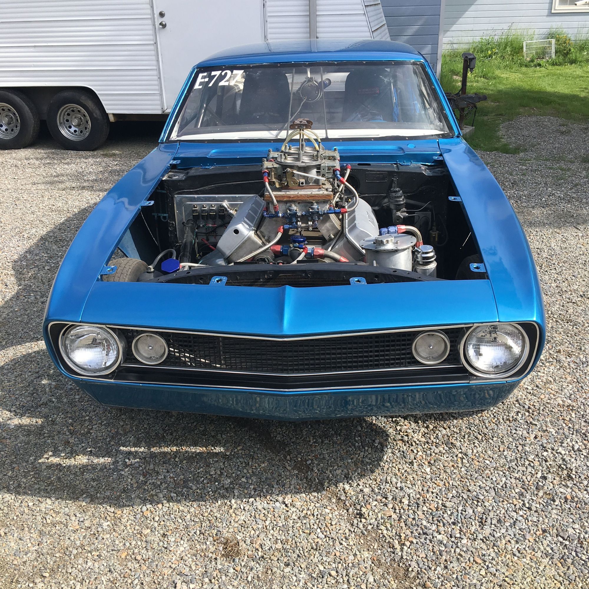

2 1150s on a 500" engine, and it still pulls about 1.5" of vacuum at wide open throttle crossing the finish line, so in theory it could still use a little more as that vacuum represents a little bit of restriction, and potential power loss however slight.If the carb is tuned right, the bigger one will always make the most power.
