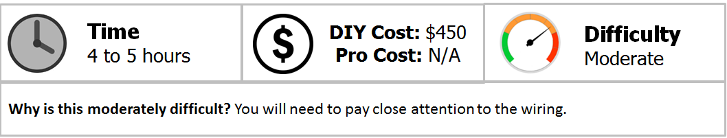

Relocating the battery from the engine compartment to the trunk creates several advantages. For folks concerned with appearances, it gives the engine bay a cleaner look . Also, it makes room for performance items like a stand-alone nitrous fuel cell. Moving the weight to the rear of the car also helps with weight transfer on the track.
This is a fairly straightforward, inexpensive DIY project. However, the cost can balloon if the stock battery is exchanged for a smaller, lightweight battery. Pay close attention to the wire ends while you make new battery cables. Failure to properly construct new wires can result in electrical gremlins down the road, which can be hard to diagnose. At worst, it can result in an electrical fire.
This installation was performed on a C6 Corvette, but it applies to any Corvette (and most other vehicles).
