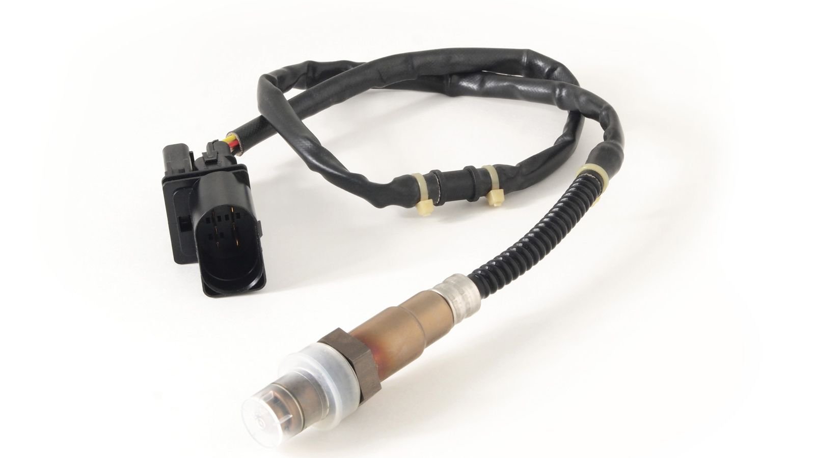

Step 3 – Check the oxygen sensor
One of the most common causes of check engine lights coming on is the oxygen sensor. While sometimes the sensor is actually bad and must be replaced, many owners have reported this problem popping up after they have an aftermarket exhaust installed. Sometimes, the sensor simply doesn't get plugged back in, and sometimes it is damaged during installation.
Figure 4. Oxygen sensors are often the culprit of a check engine light.
