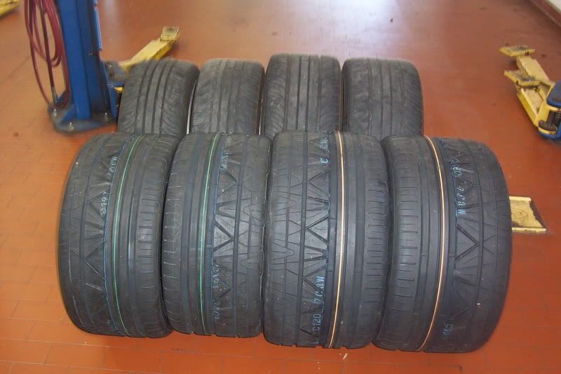

Yes. But if you run 345's on back and stock size up front you will get the engine drag control as the car thinks the rear wheels are slipping upon deceleration at high speeds. Not the end of the world, most people deal with it. You need to maintain close to the stock ratio front/rear size difference. I have a full wide body and run 295 fronts and I never get engine drag control, but my fronts did rub a little at full lock at first, they don't any more, as the tires have worn and the edge of the plastic wheel well has also.
Here are my stock wheel/tires next to my 345/295 Invos.
On the car
And here are my Invos 30,000 miles later, still going strong. I'm really happy with the life and performance of these tires.

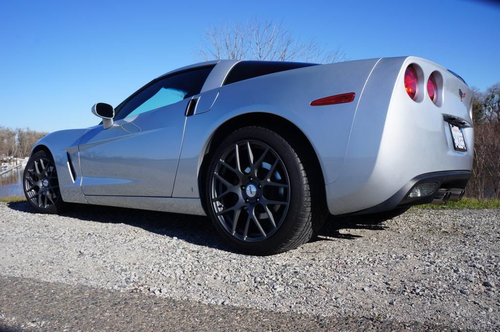

Default TSW Nurburgring
Here is my OEM sized tires on the 1/2" wider TSW wheels. As someone stated, the offsets are different than stock so bulge a little. Personally, I feel they fill up the wheel wells nicely.
