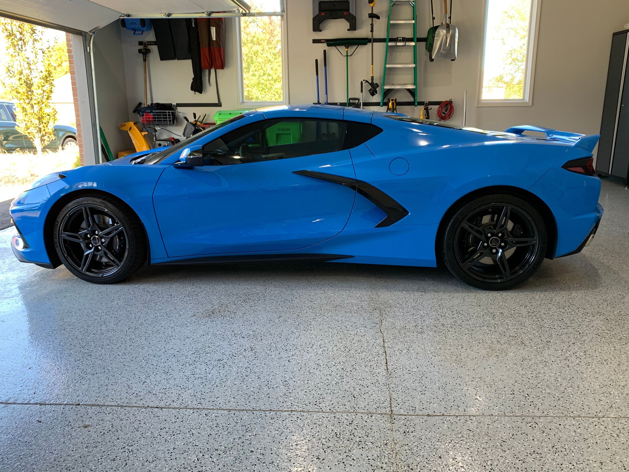

Old Oct 22, 2020 | 08:51 AM
C7orC8's Avatar
C7orC8
Joined: Jan 2018
Posts: 125
Likes: 93
Powder coated by winter wheels Carbon flash, happy to have no machined lip.
