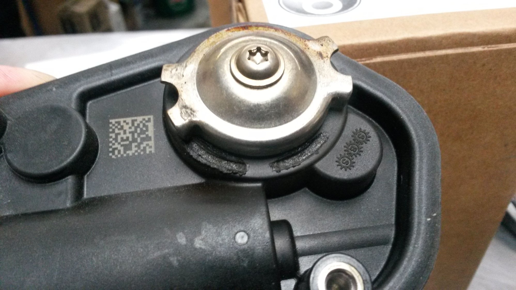

Tadge,
I hope you can clear up some questions about the AFM system and the use of plastic AFM Actuators. Some of us who purchased Z51 cars specifically to track the vehicle are disappointed that under heavy track load and temperatures the AFM actuators melt and fail. Besides throwing a check engine light and horrible noises during V4 ECO mode, could you explain what issues someone might have in just running these in this condition? What is GM’s position on replacing these? It’s my understanding from speaking to other affected users (some whom have had the AFM actuators replaced 5 times) that there is no fix for this condition. Is there a new part design coming soon for this? I’ve heard that Spring Mountain has seen this as well and it affects many of their vehicles. Can you offer advise to those affected? How do we fix this issue permanently?
Thanks for the help and insight. We greatly appreciate your honestly.

The (2) actuators sit between the cats and the mufflers, so changing out the mufflers and rear pipes will probably not have any affect. Even if you change the entire exhaust system you are probably going to re-use the actuators (although I'm not sure, might depend on the system). Many systems include new AFM valves, but these are not the actuators. I'm sure its something to do with the emissions and keeping the computer happy.

It appears I just melted my AFM actuators this past weekend so now I am even more interested in his answer.

Well they claim that they test at what like 86*? This past track weekend was mid to high 90s both days. My five other track days prior to this were all in the 80s and never cracked 90*. Curious what the outside temps were for others that melted their actuators?
Originally Posted by mallett435
I just had this happen in my Z51 at VIR this weekend. CEL while on track spooked me a bit. What codes did you get?
P26C8.
Just got my car back from the dealer yesterday (Thursday), I dropped it off Tuesday they were supposed to have the parts in on Wednesday, they were lost in transit and had to reorder the actuators. They arrived Thursday at lunch and had the car ready a couple hours later. Fairly quick turn around, would have been a full day sooner if parts didn't get lost in transit.
