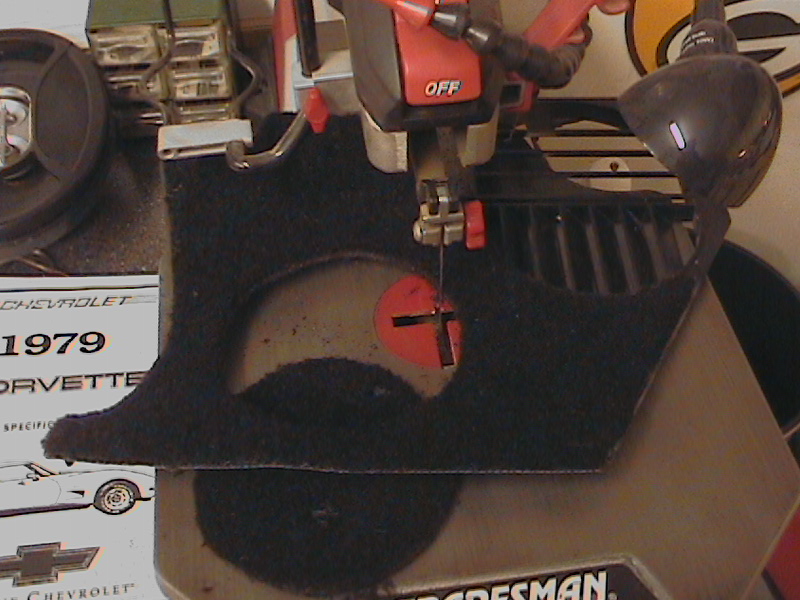

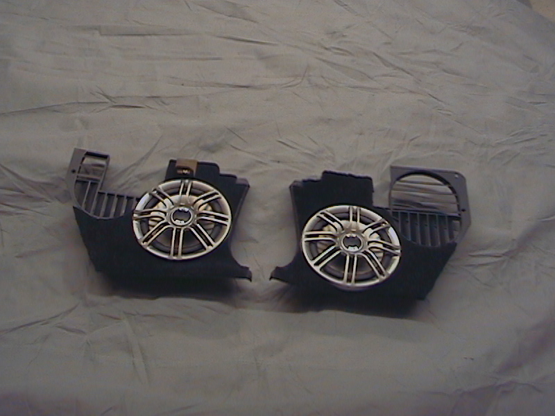

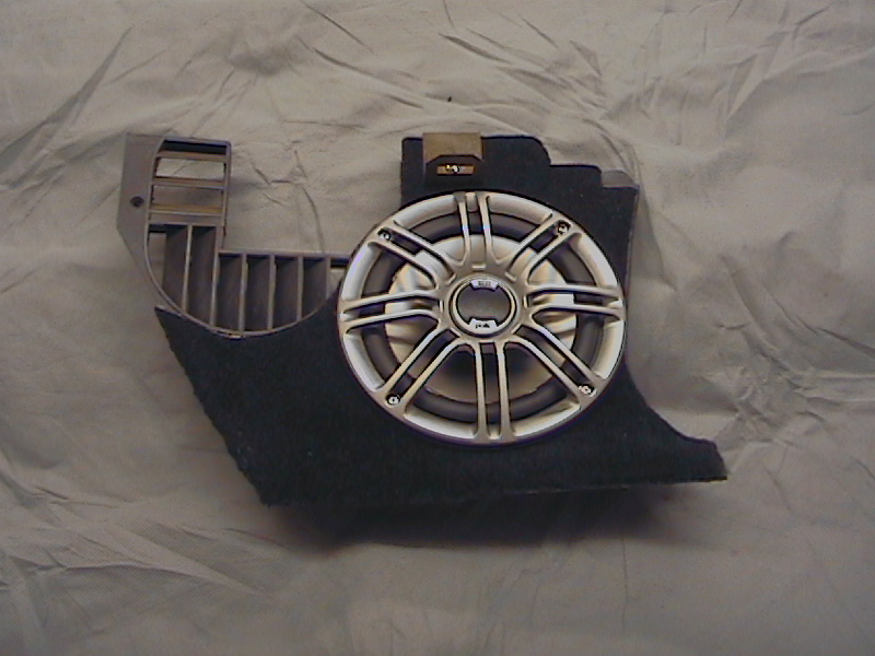

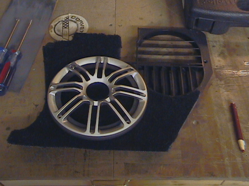

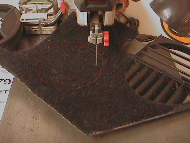

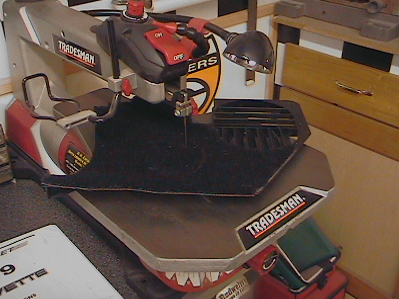

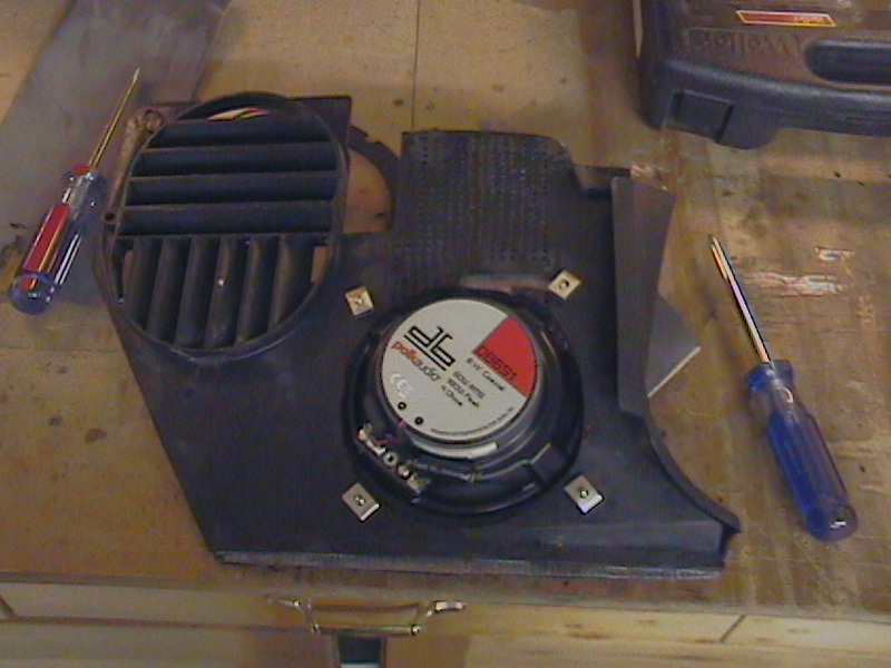

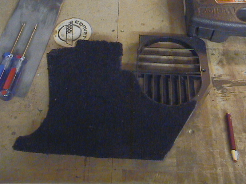

I installed them in the Kick Panels. I had already carpeted my new kicks, so I laid out the speakers where I thought they would fit best on the kicks and then drilled a 1/4" hole in them so I could place the kicks on my scroll saw to cut out the holes for the speakers. I used a wax pencil RED on the black carpet to draw my template lines. Would suggest white next time around as it is probably easier to see on black than the red.
Anyway, I got them cut out and installed and tested. They look great.

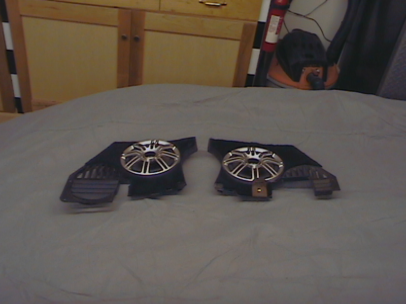

You did a great job installing the speakers in the kick panels but one seems higher than the other. Is that just me? Have you test fit them in the car?

Good observation.. It is one part bubba, and two parts the driver side just seems to fit differently when I laid it out, and the pictures are a little deceiving. With them in place, they actually look pretty similar.
Since they are not going side by side in the car, I think only you and I will ever know.
