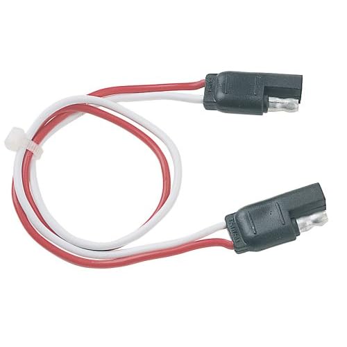

just use one of these:
http://www.cbxmanmotorcycles.com/pro...100696&affid=4
and snake the wire to the outside of the car. this is what i did on my motorcycle and i'm going to do it on my car as well

If it were me, I would skip the cigarette lighter and go with a fused disconnect. A lot of the Battery Tender chargers (Jr, Plus, etc...) have a 2 pole disconnect that you could connect to.
Maybe you could buy something like this, perhaps:
http://www.amazon.com/s/ref=nb_ss_au...nector&x=0&y=0
I believe that you can find these at Autozone, Pep Boys, etc... and some of them have a protective cover to keep the dirt out of the terminals. Just make sure that the + and - are correct, and be sure to put in a fused disconnect at the battery/fuse box. (Make sure that the protected/female end is + at the car to prevent a short circuit.) You may want to buy a couple of them and make up a "C4 battery charging specific harness" for this application.
Make sure to use a decent sized wire... the Battery Tenders have a microprocessor that can sense the current and voltage and adjust it's output accordingly. If you use too small of a wire, you will have a voltage drop that could make the charger think your battery is okay when it is not.
If it were me, I'd probably go with a 5 amp fuse and a 14-16 AWG wire.
Let me know if this helps.
You beat me to it, ScottFX!
I think he needs one that is a bit longer to reach the rear of the car... but there is no reason you couldn't extend the length of the one you listed. Good find!
