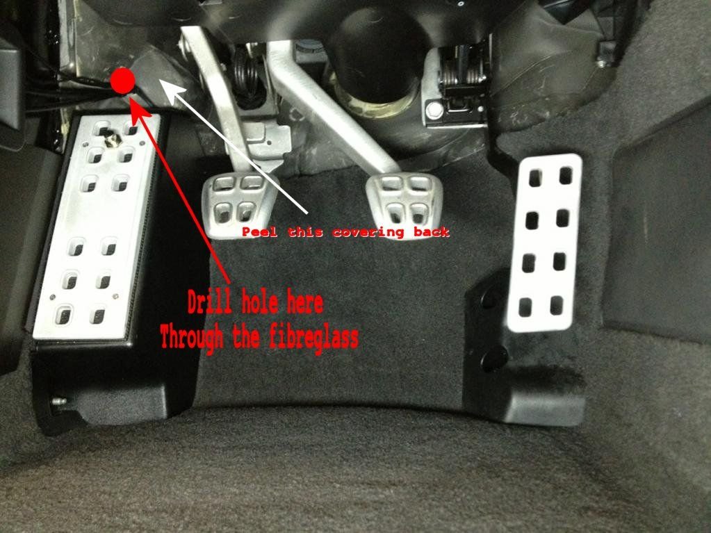

Can someone post a picture of exactly where to drill the hole on the firewall of a Base C6 to install the power wire for an amp? Thanks

See this post:
http://forums.corvetteforum.com/1579888487-post9.html
This entire thread was immensely helpful for my stereo install.
This post: http://forums.corvetteforum.com/1556495345-post3.html
has a better view of where to drill.
I wish I had taken more photos of my install, but alas, I was in a hurry to get it done and really only got pictures of the finished product.

I drilled a 3/4" hole just above the dead pedal on the drivers side. The hole is just below the Brake booster. I used a curved coat hangar with the wires attached (electrical tape) to fish it out to the engine bay.
I was running wiring from my front facing camera for parking.
Once the wires ran through the hole, I sealed it with duct putty sealing material to keep any moisture out. Works like a charm.

No need to drill SMH. I hate adding any holes. Remove battery, run through stock rubber grommet below and behind battery, and re-tape.
