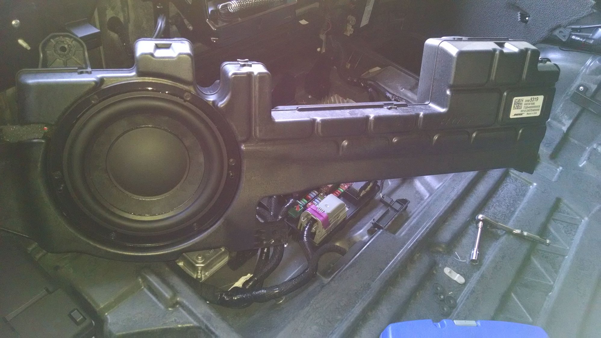

Subwoofer from 2LT/3LT. The enclosure is vented to the opposite side from the woofer. It seems like pretty light weight material so in an effort to get some better bass response I added some deadening. I am VERY pleased with the results be doing so.
Up-close on the vent

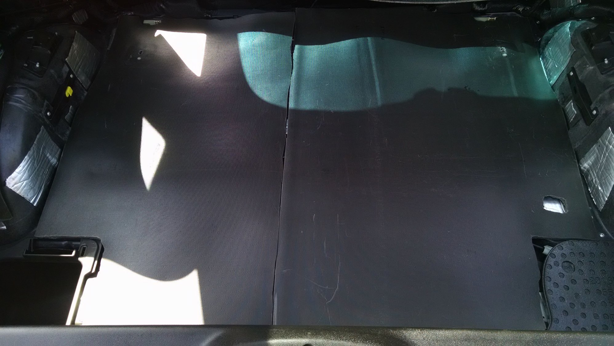

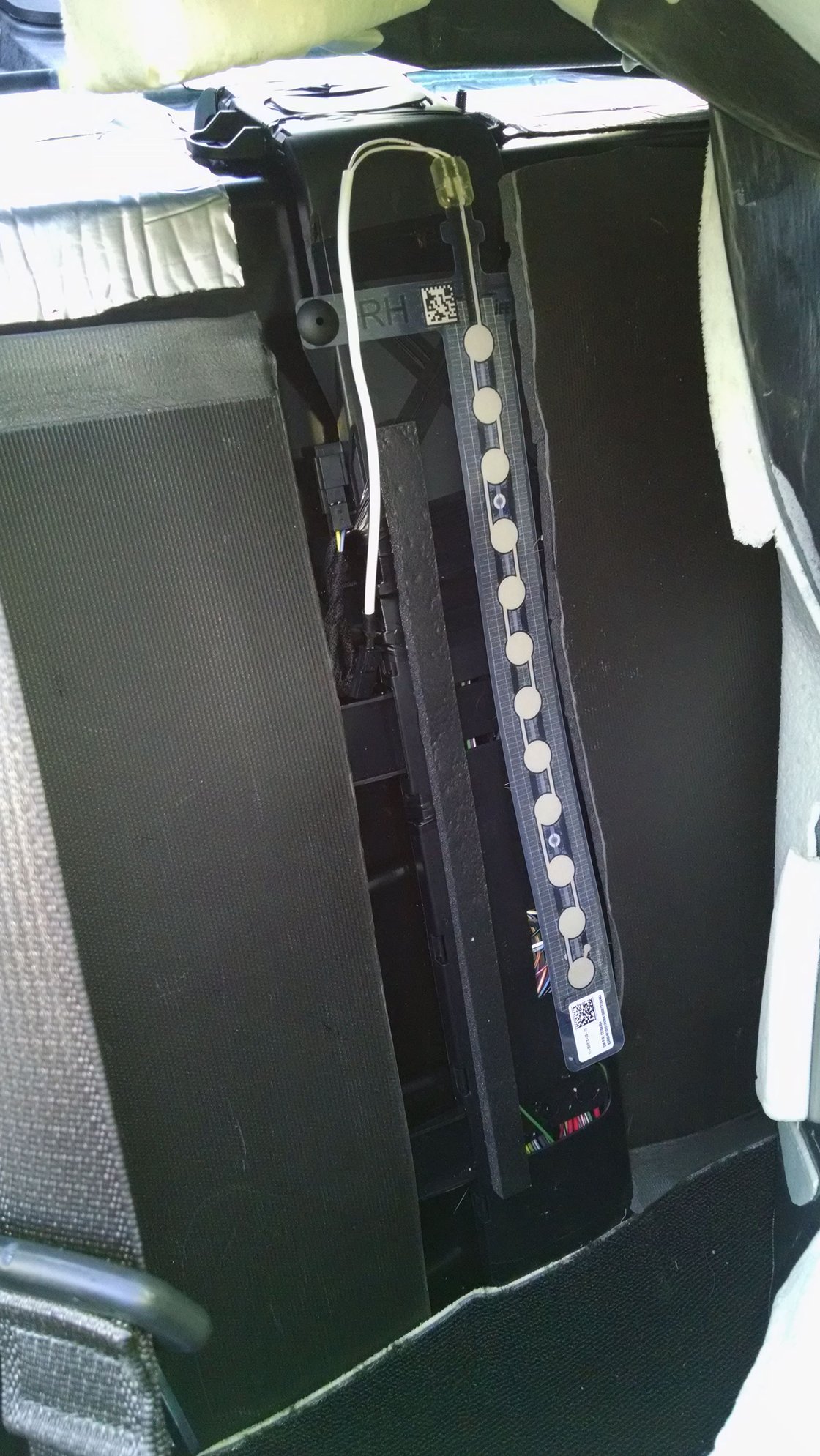

LLpro behind the seats
LLpro covering the rear. I still hear the exhaust just fine when I get on it, but in tour just cruising it is barely there. (I have NPP fyi) Great result for my long trips.

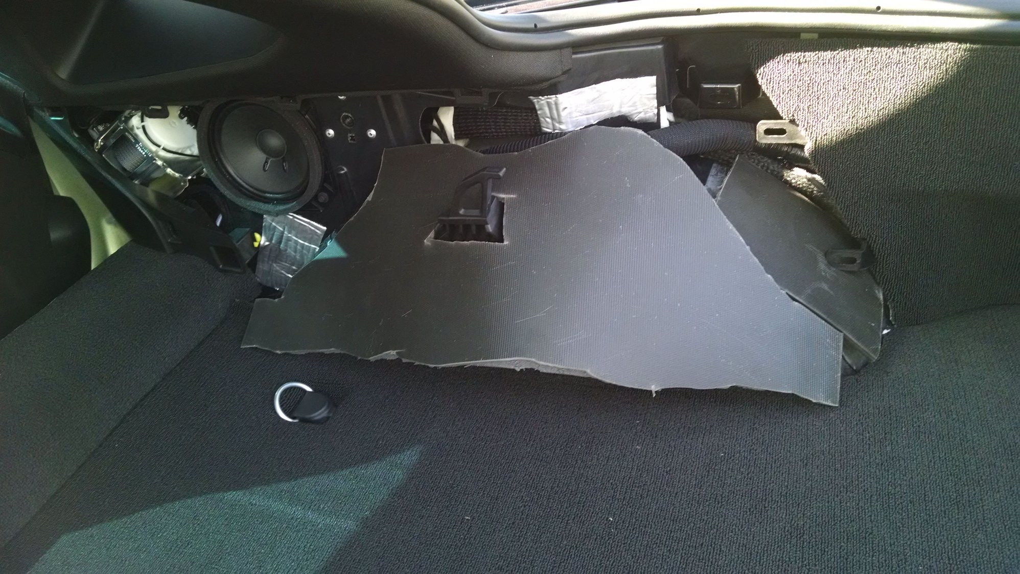

BQ and LLpro on the rear trim over the wheel wells. The white material is the GM attempt to absorb sound throughout the car.
Another sheet of LLpro over the wheel wells with a cut out for the targa mount
