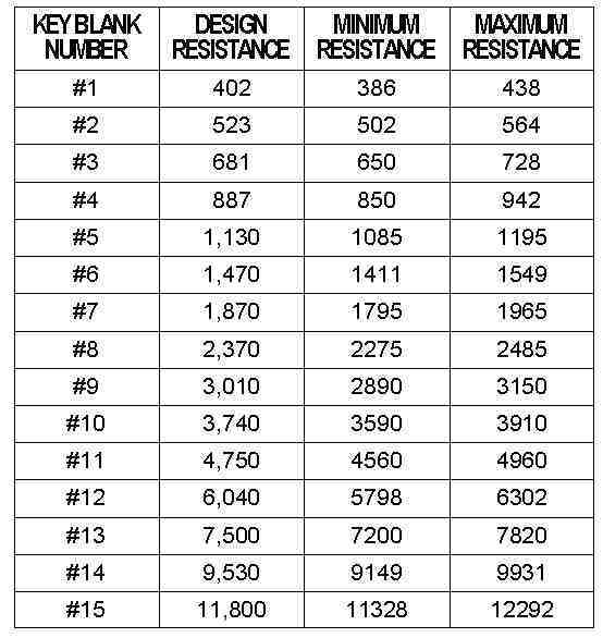

The trick is, you need to know the resistance of the "pill" on your existing key. If you had that there are places online where you can order blanks. Without that, my guess is you'll have to go through a dealer.

Use an ohm meter to determine which blank you need, then get it on ebay for under $20 and cut it at Lowes.
