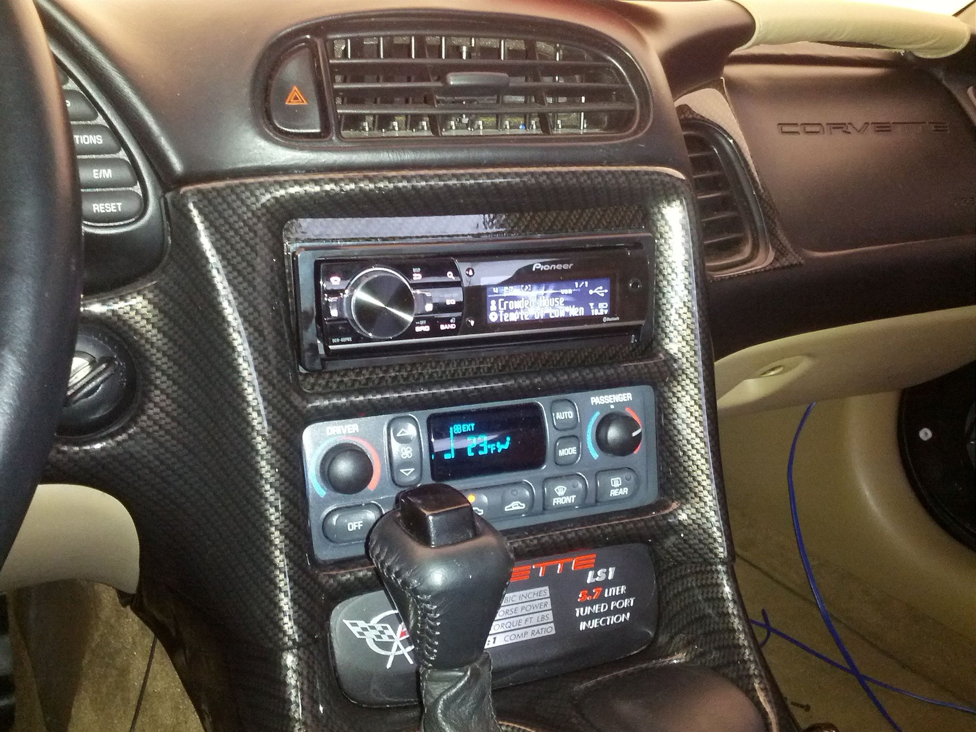

Here is the first tear down to start the head unit install.

I had Dennis at DoubleD Mods do a Hydrocarbon covered bezel so it would match the Carbon fiber look that was put in the car before I purchased. He really matched the color perfect.
