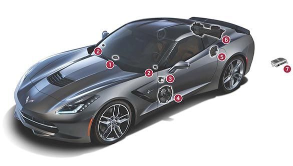

Yes. There is a sea of options in the aftermarket. You can get more output, lower harmonic distortion, better low end extension. An MDF spacer is usually all you need to make the speaker fit.
I won't be messing with the stock box, I don't even have one since I have the 9 speaker system. I'm building something from scratch.
Here is the factory box btw:

Originally Posted by jonparks
Anyone know what the replacement speaker sizes would be. I have several speakers left over from my c5 and c6 stereo replacement projects. Looking to find out what I have that will work and what will need to be purchased.
exact same as the C6...
3.5 and 10" in doors
5.25" in rear.
I ahve adapter plates for the doors as well
