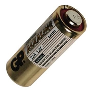

These leds must have resistors built in? Because 9v would of blown them out.
You can get a battery that is smaller then a AAA battery that is 12v at home depot I believe. Used mainly for remotes.
They look like this.
And yes, if they have resistors built in, you are cutting down the 9v power and not reaching full brightness the 12-14v a car would be putting out, which would be resisted to around a final voltage of 3.5v is my guess.
If this is the leds on a roll type strip, I have built shoes that light up off that small 12v battery. They were BRIGHT!
