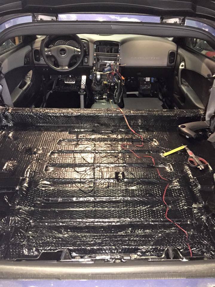

Began my new system install yesterday. Most of the interior is out, sound deadening done in the trunk, backup camera installed, and a little bit of misc wiring. Still have to take the door panels off and apply sound deadening. I'm not good at taking and posting pics of the work I do, but Ill try to post pics when I can.

Well, you can see I'm not real good about keeping things up to date. As of yesterday around noon, I started putting the interior back in the car! This took a lot longer than I wanted, but we have had things going on every weekend and its been hovering around 100 degrees each evening when I get off work, so I haven't had a whole lot of time to mess with it. I stopped last night around 7 because I was about to throw the passenger side trim into the street and run over it. This is the piece that you step over when exiting the car. I figure there is just something I'm not seeing that is keeping it from aligning up correctly. Everything else has went back in without a problem. I have only broke one part, one of the little pins that hold the rear speaker trim to the halo trim piece. I also stripped out both circle plugs that go on the rear wall. So other than those minor problems, this has went very smooth!
I did a couple of tests before putting the interior back in and wow, it is going to sound awesome! The hard part for me is going to be making the correct adjustments between the head unit eq and the amp. I don't really understand the settings on the amp, so I probably need to do some research.
Dennis (Double D Mods) has been fabulous! Ive had several questions through this process and he has answered my emails within 10 or 15 minutes! My wife an I are celebrating our 11th anniversary today, so we are going to Denton, Tx (long story) for the evening, so hopefully when we get back tomorrow, I can finish it up!
A big thank you to Dennis and another for this forum! I don't know how many times i got on here to see how to solve something that I ran into. Ill try to post some pics after everything is back in order.
