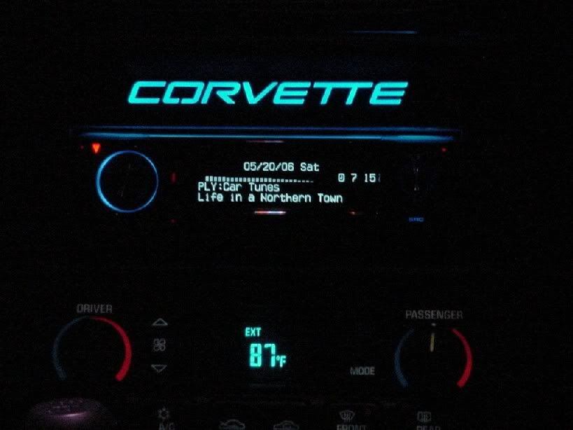

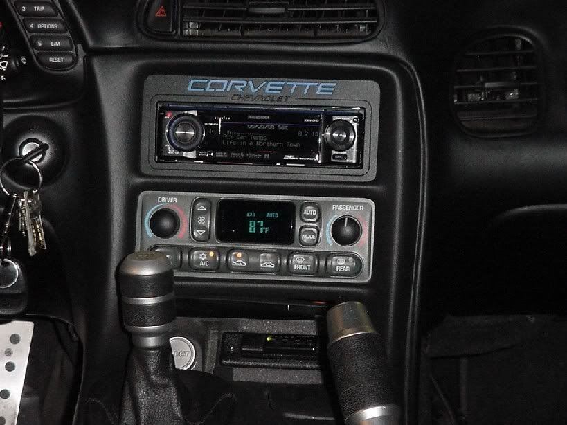

Metra 99-3300 is the $10 mounting adapter, or check out HUmount.com for the illuminated logo version
