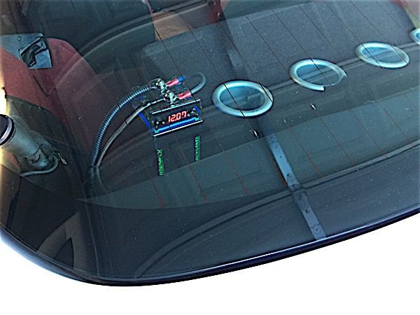

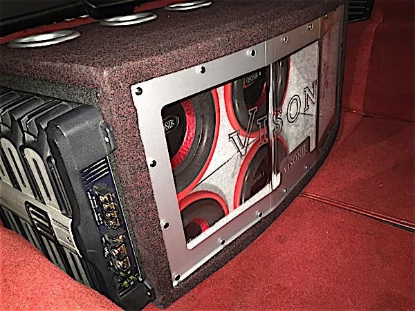

2015 Post by CebuRyda-This post was in 2015 and I do not know what became of the poster or his problem. This reply is in 2023. 05JUN2023: I have designed some of the winningest car stereo systems in this country. The car's battery, which is a large capacitor, are all inadequate to run a large hi-power stereo system in a car. This was discussed at length in the 1980"s with the advent of Hi-power amplifiers using 12VDC electronics. Many people shoved huge alternators into the cars in an attempt to put more charge in the battery being used by the huge draw from Bass notes on their systems. The method was pretty much a failure and very costly. I finally figured out if the system had a very large capacitor between the battery and the stereo system, was isolated from the alternator and only allowed power to flow one direction: from the battery, to the large capacitor, to the amplifiers, as the Bass notes sucked the power out of the large capacitor, the now known as Mega-Capacitor, would recharge from the battery in 1/15th of a second and be ready for the next Bass note. Using a 1 farad capacitor for every RMS 1000 watts of amplifier power creates this assist. Using more capacitance will reduce the load and time to recharge even more. The regular alternator would continuously recharge the battery and the system would be able to produce these loud Bass notes. A 1 farad capacitor is the size that works. 2 of them in a series will allow the battery to recharge from the alternator faster without the car or system noticing the drawdown. Today, there are 3 farad capacitors being used for this application. This is common knowledge amongst the best Hi-End Car Stereo Installers. A former instructor at the very first Autosound Installation Certification, held in Raleigh, NC in 1989, sold the technology to the Installer Institute in Florida: An installer Certification Program now called MESA, which he helped start there in the early 1990's. His was the first car that I tried this technique on in Raleigh, back in 1989. You can buy these online from electronics parts stores and Autosound Electronics companies. Let me caution you severely though: A 25,000 µF, MFD, or mFD (microfarad) capacitor will throw you across a room quite nicely if you touch the + and - poles when it is charged. A 1 farad capacitor is 4 times more dangerous and can kill you in a microsecond. Be very careful handling these or allow a professional to install them and set-up protection for you from them. DS (AUTOSOUND SPECIALIST from 1979 to present).
