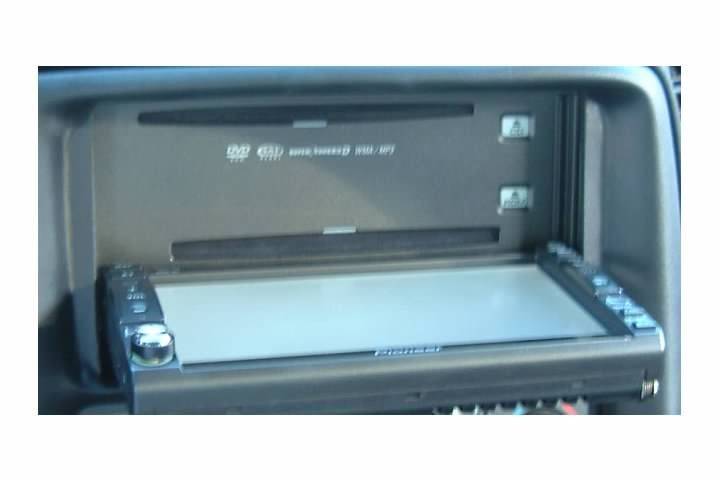

Thinking about updating the stereo in my 1999 to a double din. What exactly do they do to the surround to get it to work? Anybody have a picture of a stock and a modified surround side by side? Thanks for any info, I'm a little lost.

You have to expand the radio opening up and down, and then narrow the sides in.
I did mine in 2004 before there were tons of options. I was told it would not fit, it fit with some work on the antenna connection. (It was hitting the AC box)
I got it in without having to move the AC controller. I did this by grinding the top up. Grinding the bottom down to a really thin piece.
Then refilling the back pieces and tons of sanding
I glued in 2 plastic sides to fill the side gap.
I later changed it to where the sides did a curve in so the opening was narrower. Over time I think heat caused some movement and visible lines of the change showed up.
I want to put more stuff in mine now, so I cut that sucker all up, it is a very painful process putting it back together. Make small cuts
You might want to check out http://www.doubledmods.com/ as well.
Also, you have to mod the frame for all the stuff in the console. I did not want to remove it so I drilled a lot of holes in the back and bent it down. I should of just removed it and cut it. Which I did this time around

SIDE BY SIDE
BEZEL OPTIONS

thanks for the picture. I can see it now.
