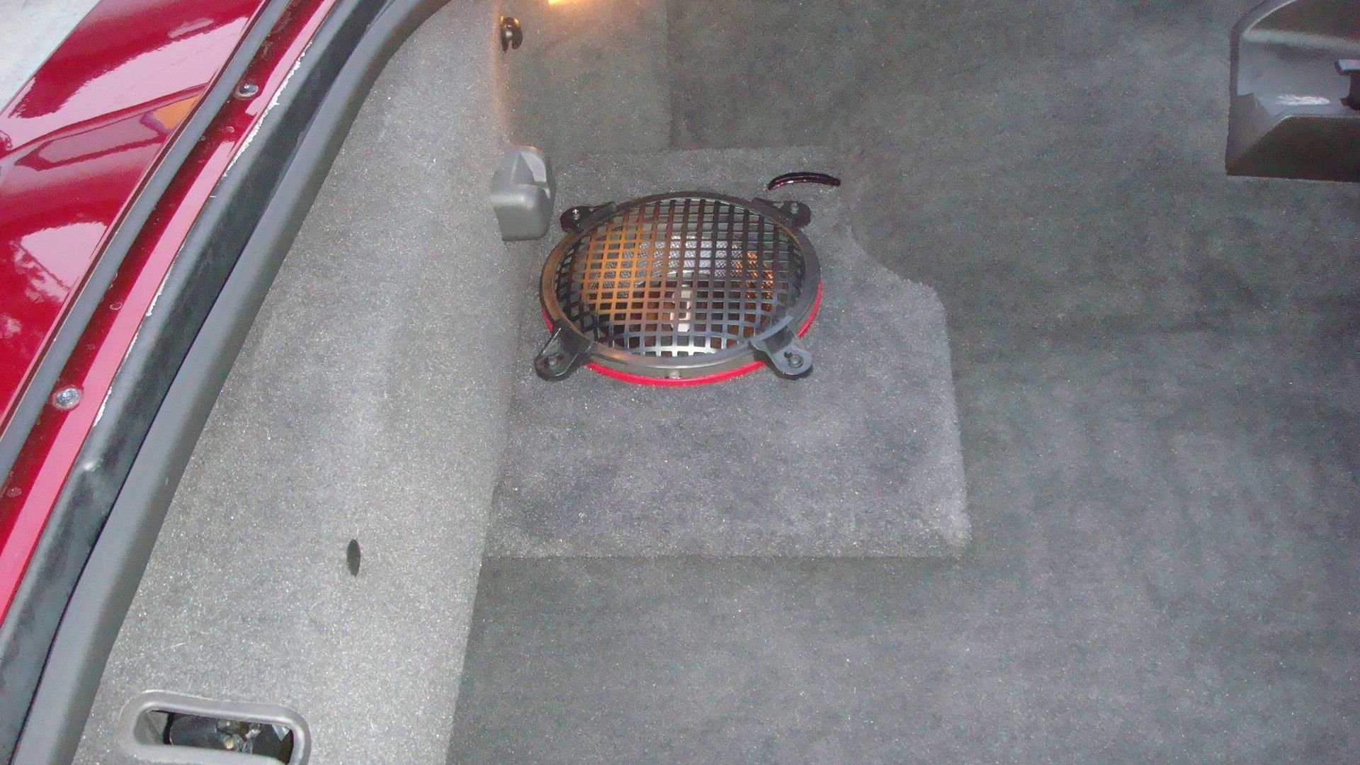

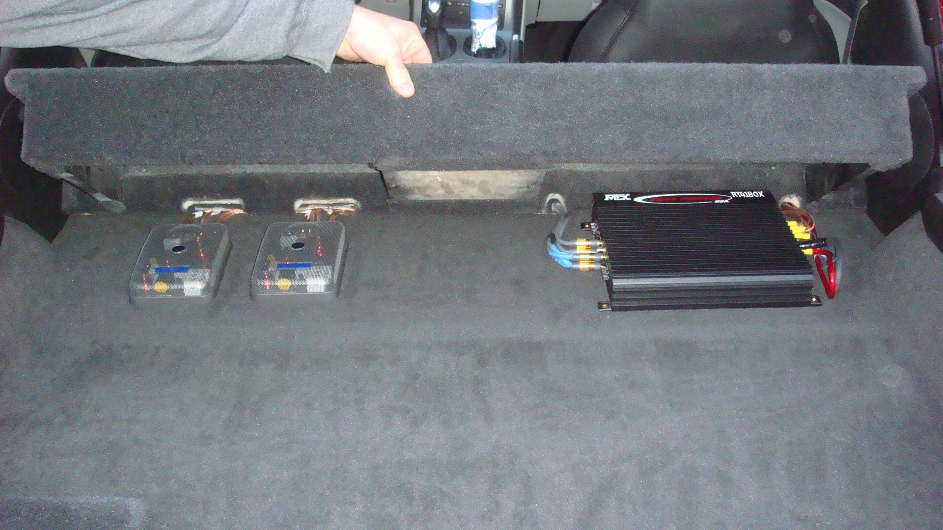

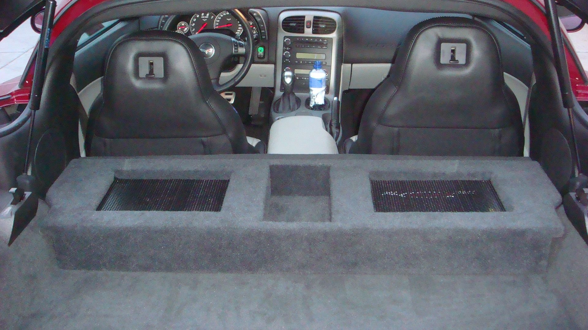

It has been many years but I pioneered changing the speakers and HU in a C6. I am an Audiophile and was forced to get BOSE with my C6, if I wanted it in 2004. I initially stayed with the original HU and pulled all the BOSE crap out I put in MB Quartz components. The Woofers in the lower doors the tweeter in the upper doors, powered by a Kicker 650W amp. I made a small box that ran across the back of the hatch with factory carpeting that hid the amp and the crossovers so when you looked in the hatch it looked like it belonged. I did have screening for cooling but was barely visible from the outside.
Now for the mind blowing part of the setup. I put a JL 8" sub in the rear right compartment(which I think was the larger of the two), and built a mount/cover for it that looked exactly like the original cover. I covered the entire inside and outside of the compartment in Dymamat to strengthen it. I built 3+ inches via 3/4 MDF above the original cover to give it some more volume which I kept adding to, to get the sound I wanted. I filled the compartment just a touch over 1/3 rd with Polyfill and that sub would simply kick ***. I could feel it pushing the back of my seats. I had to remove some polyfil to get it right. In all honesty it took a fair amount of futzing to get it where I wanted it for my music tastes, yours may vary
You need to have some carpentry skills but it was pretty simple.
If you looked in my C6 you would have no idea I had a custom system in it.
I got a Pioneer Double Din Navigation Unit and it was much better than the stock HU.

It was so long ago it looks like I deleted my pics. but here is my post on it and shows a post I followed that still has pics
I did find a few pics from my neighbors car. The difference being I put a full cover over my sub and built it up another 1 1/2" to ad a bit more volume and covered it in carpeting, so it was invisible. I might have another source of pictures, just not available at this second.
