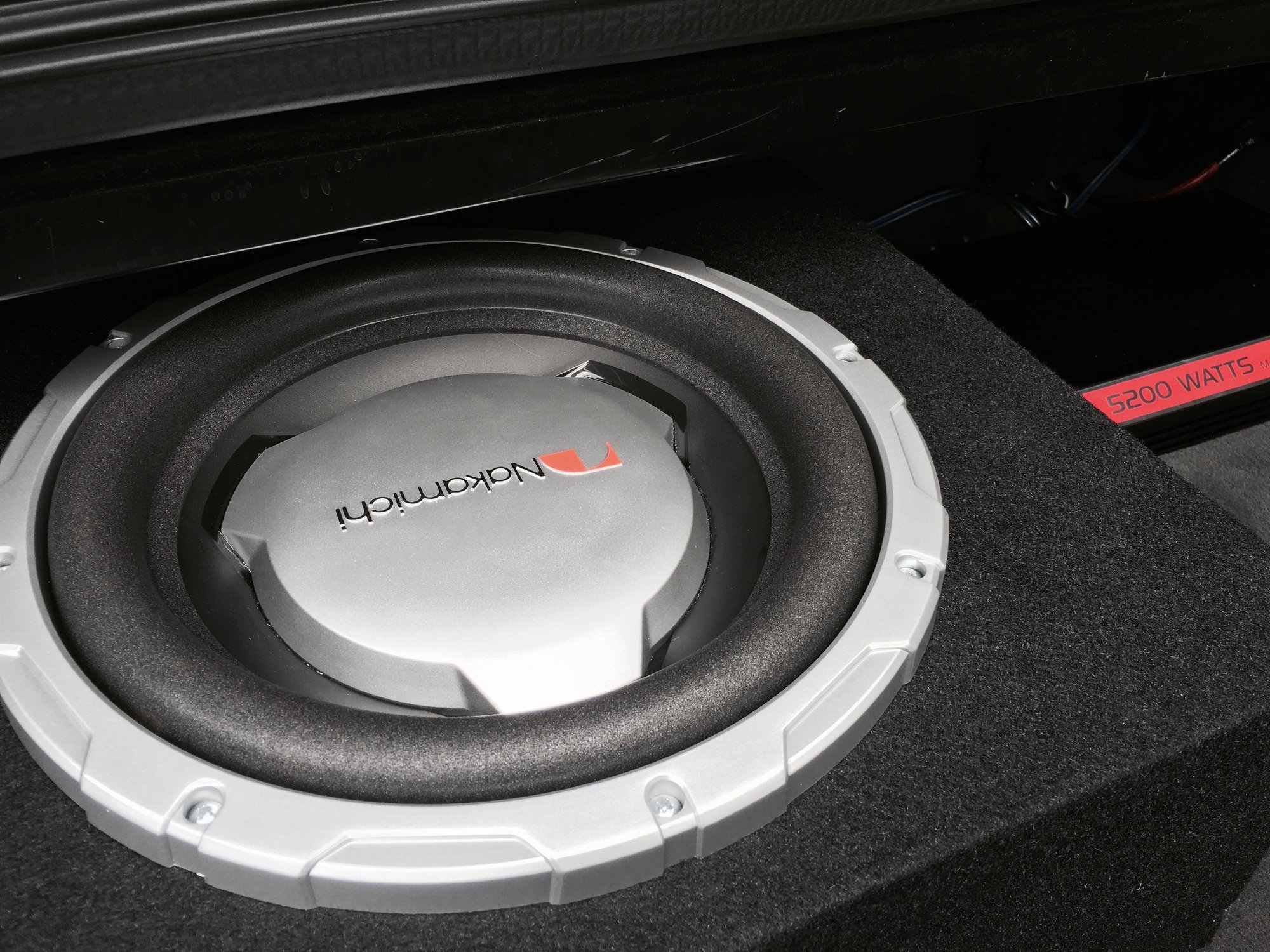

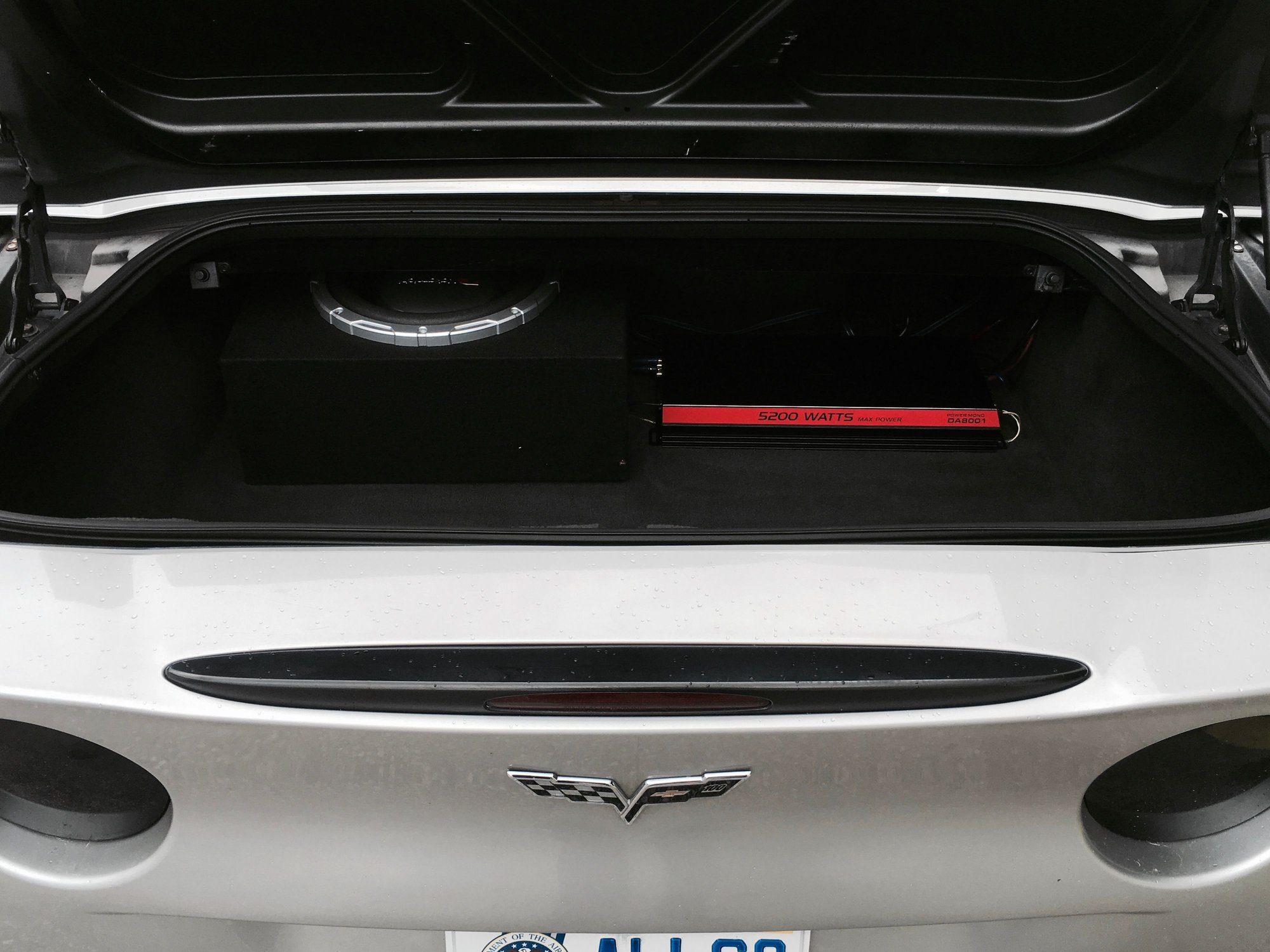

Looks Good! I just threw away all the old BOSE and replaced with nakamichi. Sounds incredible. Took a white to install....
