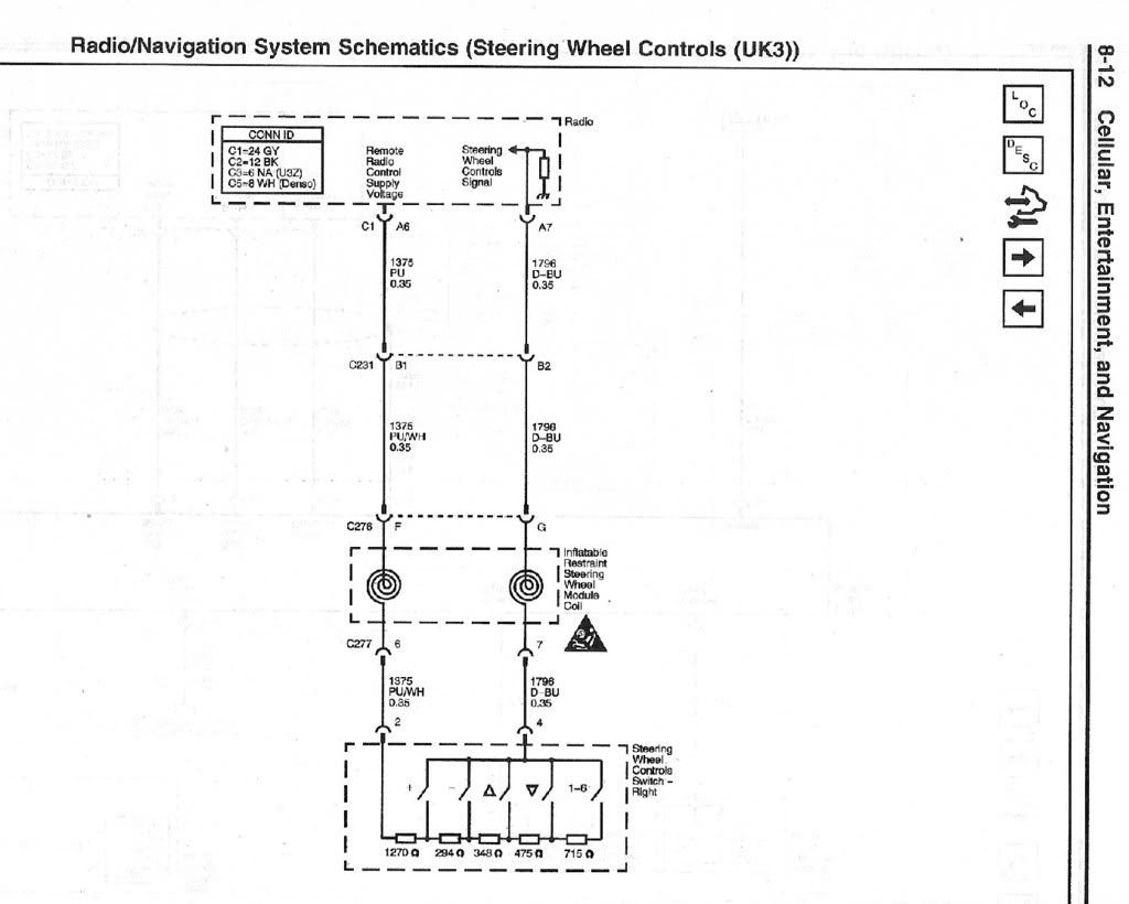

It should work just fine as long as the new radio or SWI adapter (if aftermarket) is programmed for the additional buttons. The prints below are for the original volume/channel only buttons and then with BT buttons added.
The same two wires go back to the radio for each version

Thank you for the response. I respect your answer, but we still have not had anyone try it and confirm that it does in fact work.
I did it in my 2007
I replaced my stock 2007 non-BT wheel with this one and all 7 buttons worked on my aftermarket HU through the SWI adapter.
Just before trading in the '07 I removed the aftermarket radio and reinstalled the stock CD changer HU. For the brief time that I had the new 7-button wheel in with the original radio (not programmed for BT), only the 5 buttons on the right worked.
The only concern I would have is with the plugs in the new wheel not being compatible with the connector in the car, but as I mentioned earlier, the wires can be spliced if needed. As long as your SWI device is pre-programmed for BT controls, or can be manually programmed, then this should work.
