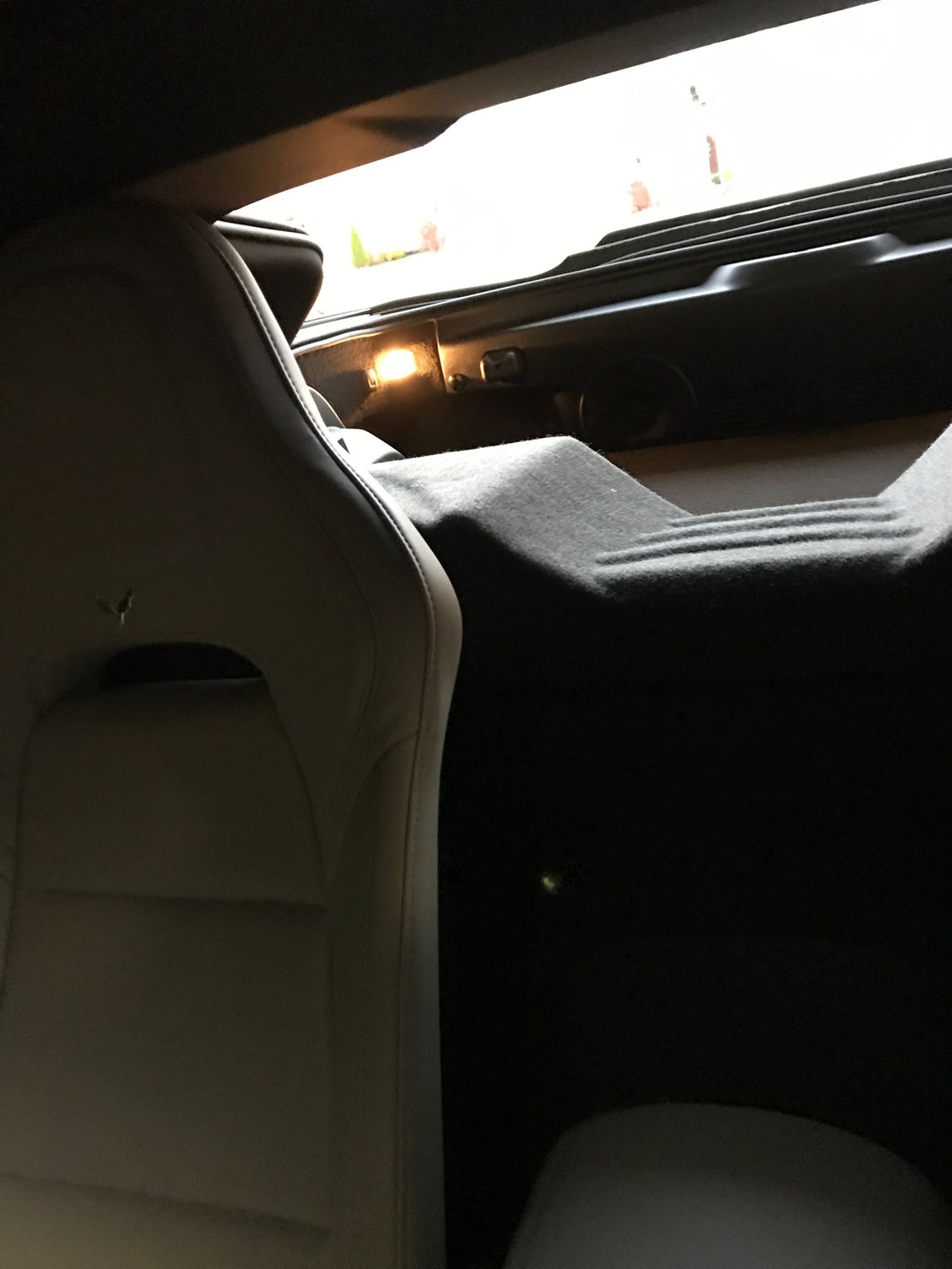

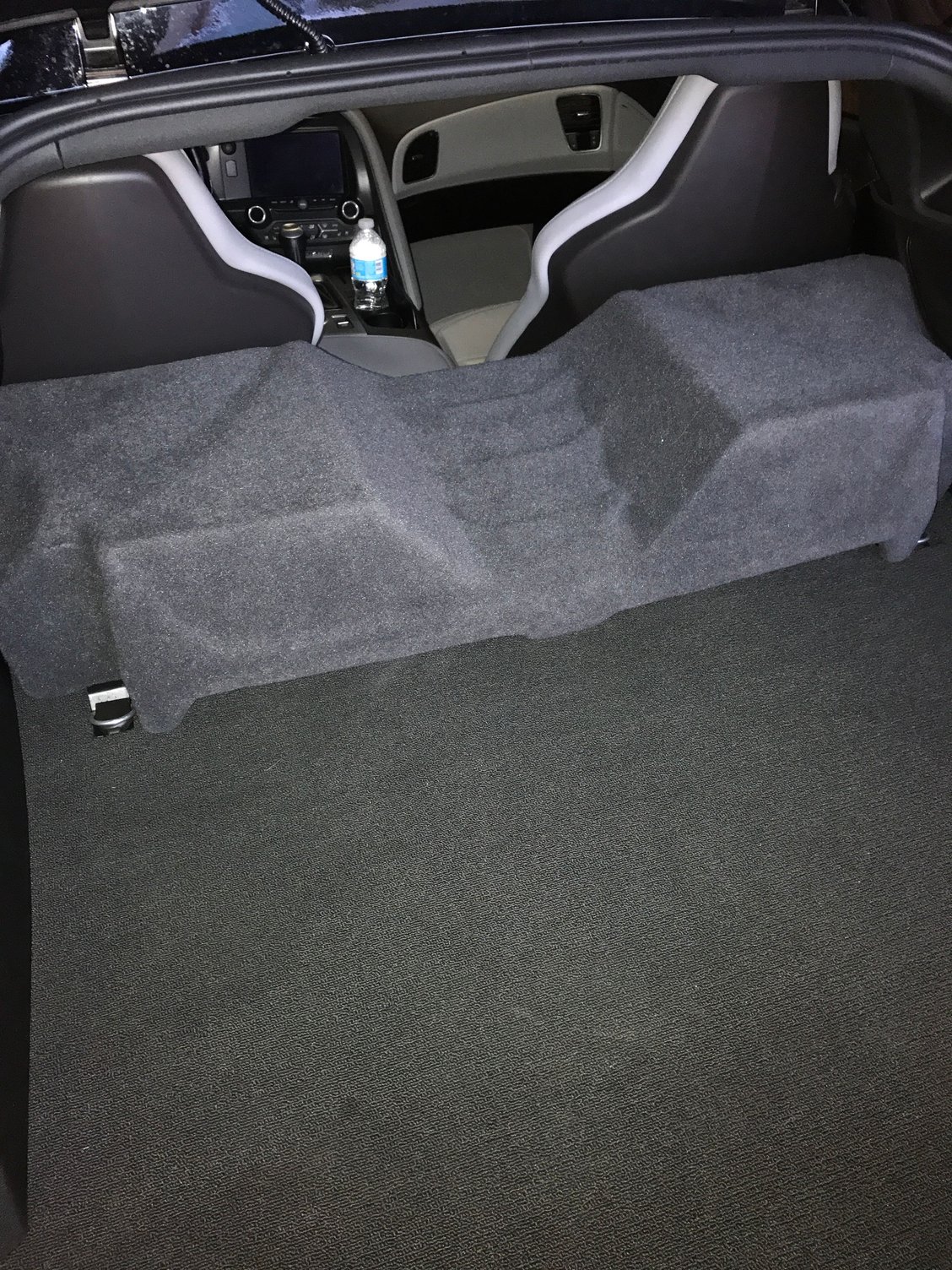

I did the 2 10" JL Stealth box and it rocks for sure but a small rattle in the box because it's not all the way reinforced to the floor.

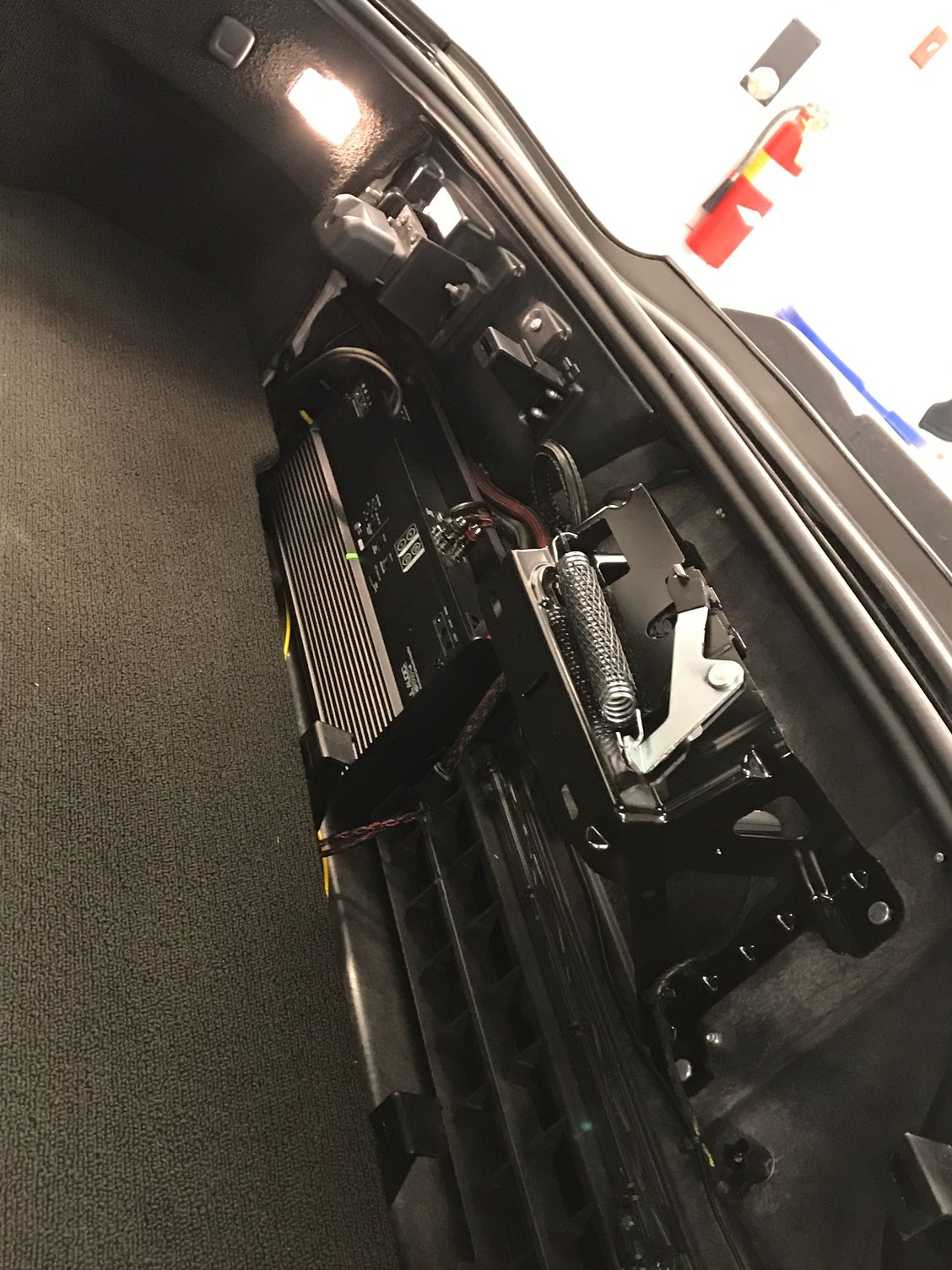

Amp install.
