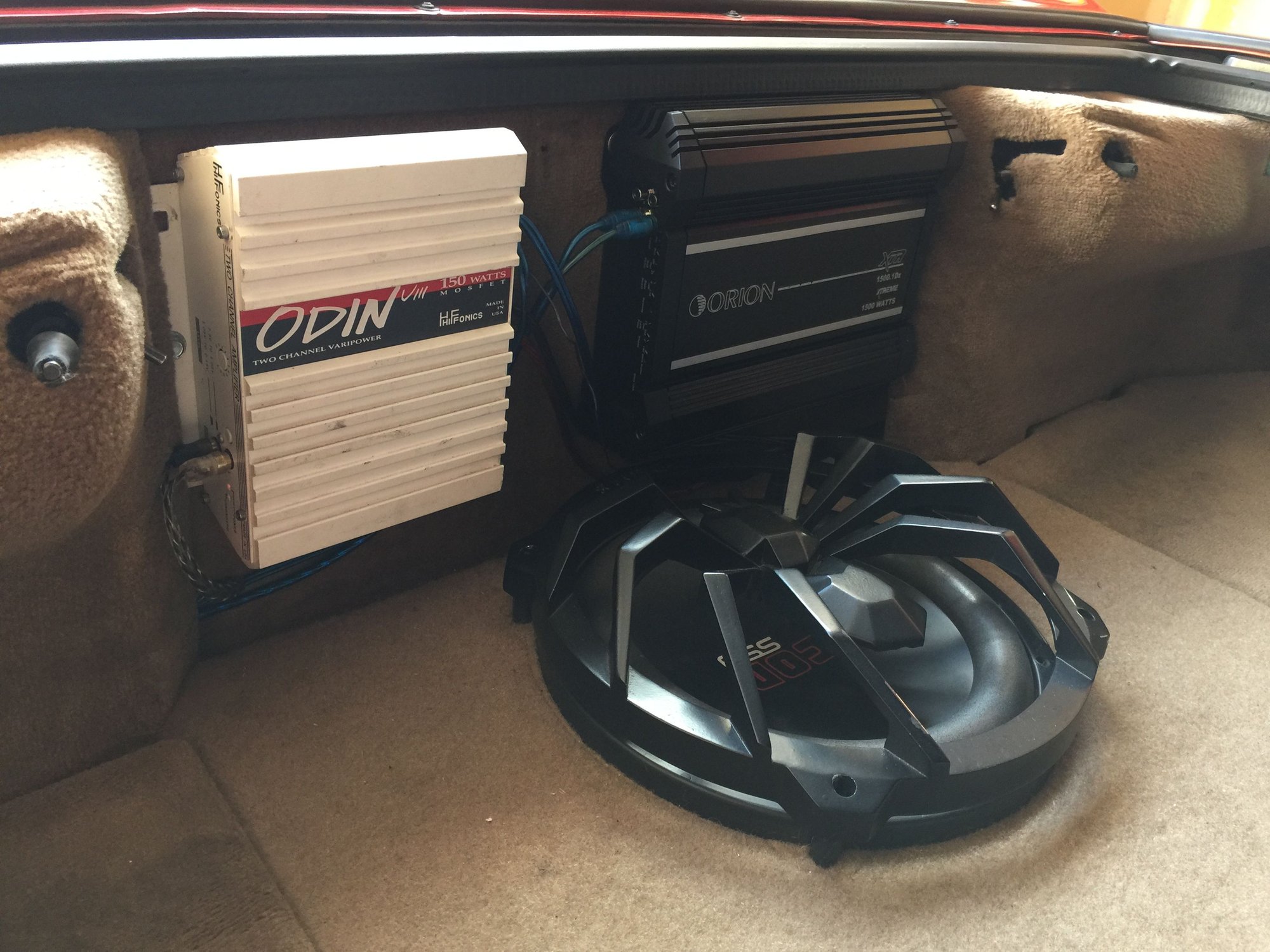

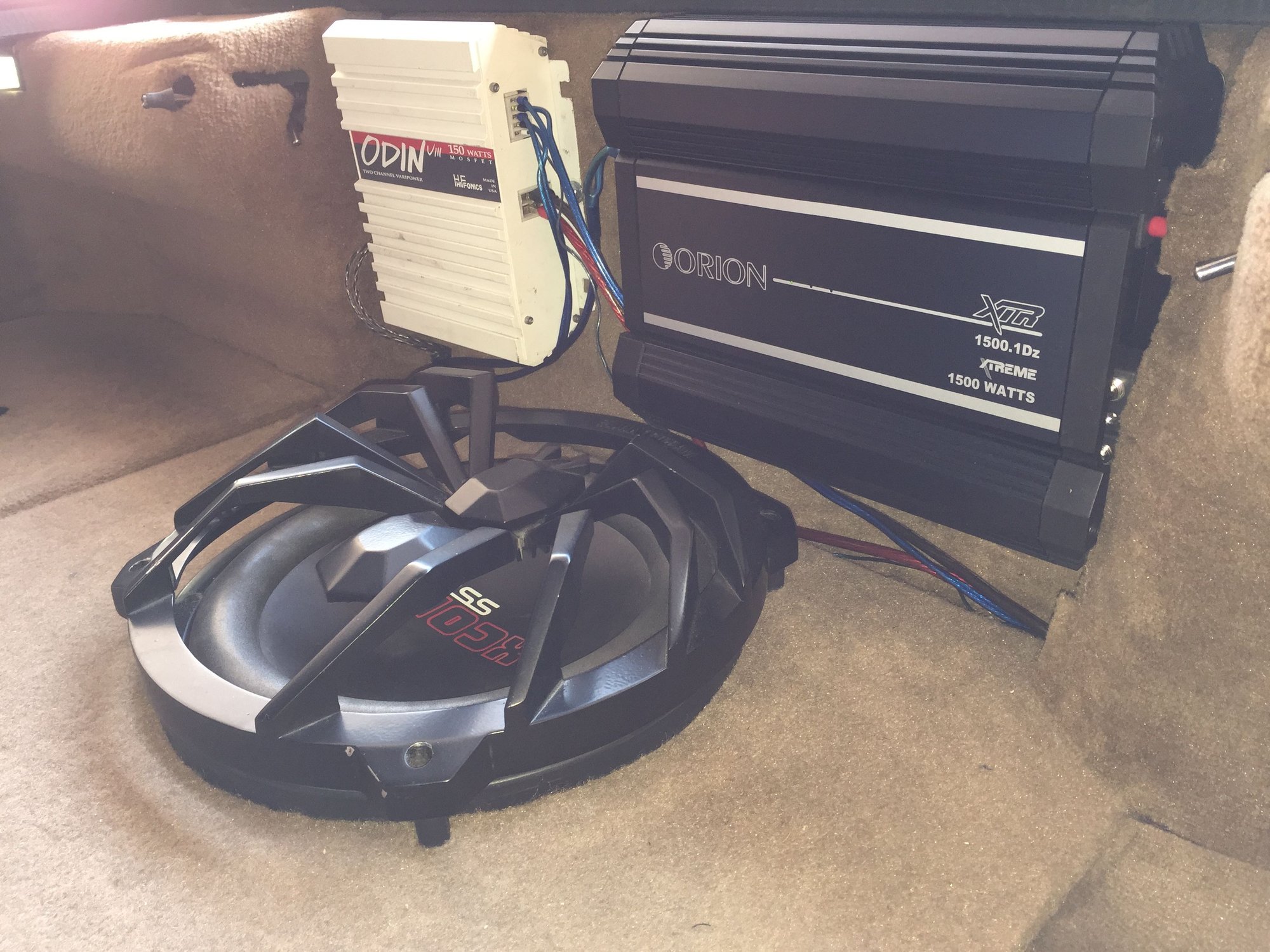

I run a single 12" SSA XCON powered by an Orion XTR 1500.1 This sub/amp combo gets crazy low and loud when called upon.
As far as your original concern over things damaging your sub when you have stuff to haul, I use a soundstream spider grill which protects well and looks better than a standard waffle grill to me.
I had to space the grill up with 1" nylon spacers because my sub would hit the grill at it's standard height.

just noticed the hifonics odin. that's a series 8 it looks like which would make it about 20 years old. that's a long long life for a car amp.
Old Dec 12, 2017 | 04:35 PM
jdmvette's Avatar
jdmvette
Night Owl for life
Joined: Nov 2003
Posts: 24,721
Likes: 4,557
Yes, original owner here. Bought the Odin back in my youth in the 90s.
This amp is all original, never been serviced and sounds great.
