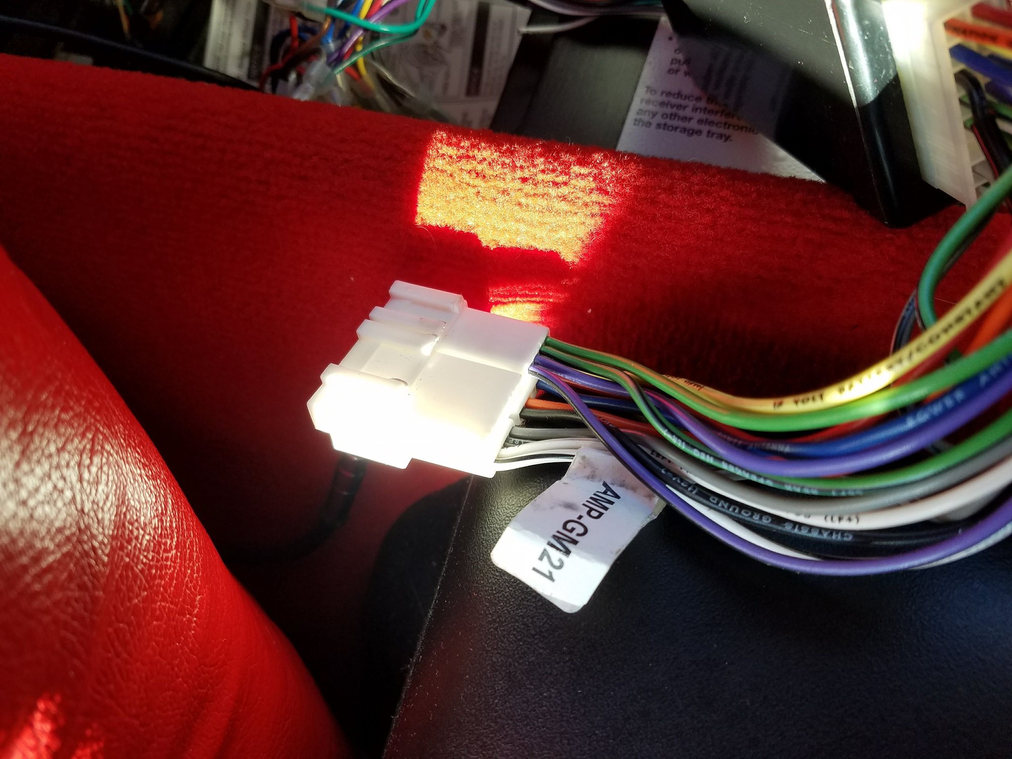

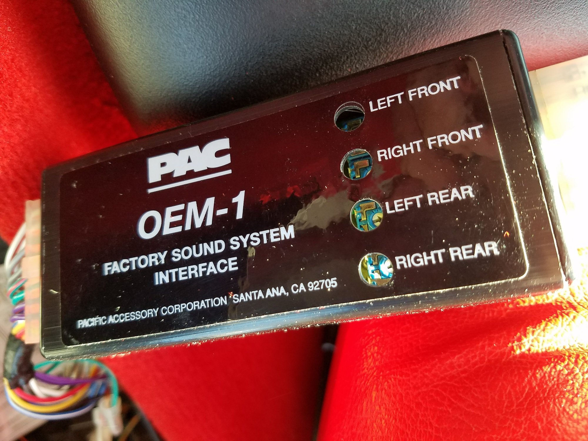

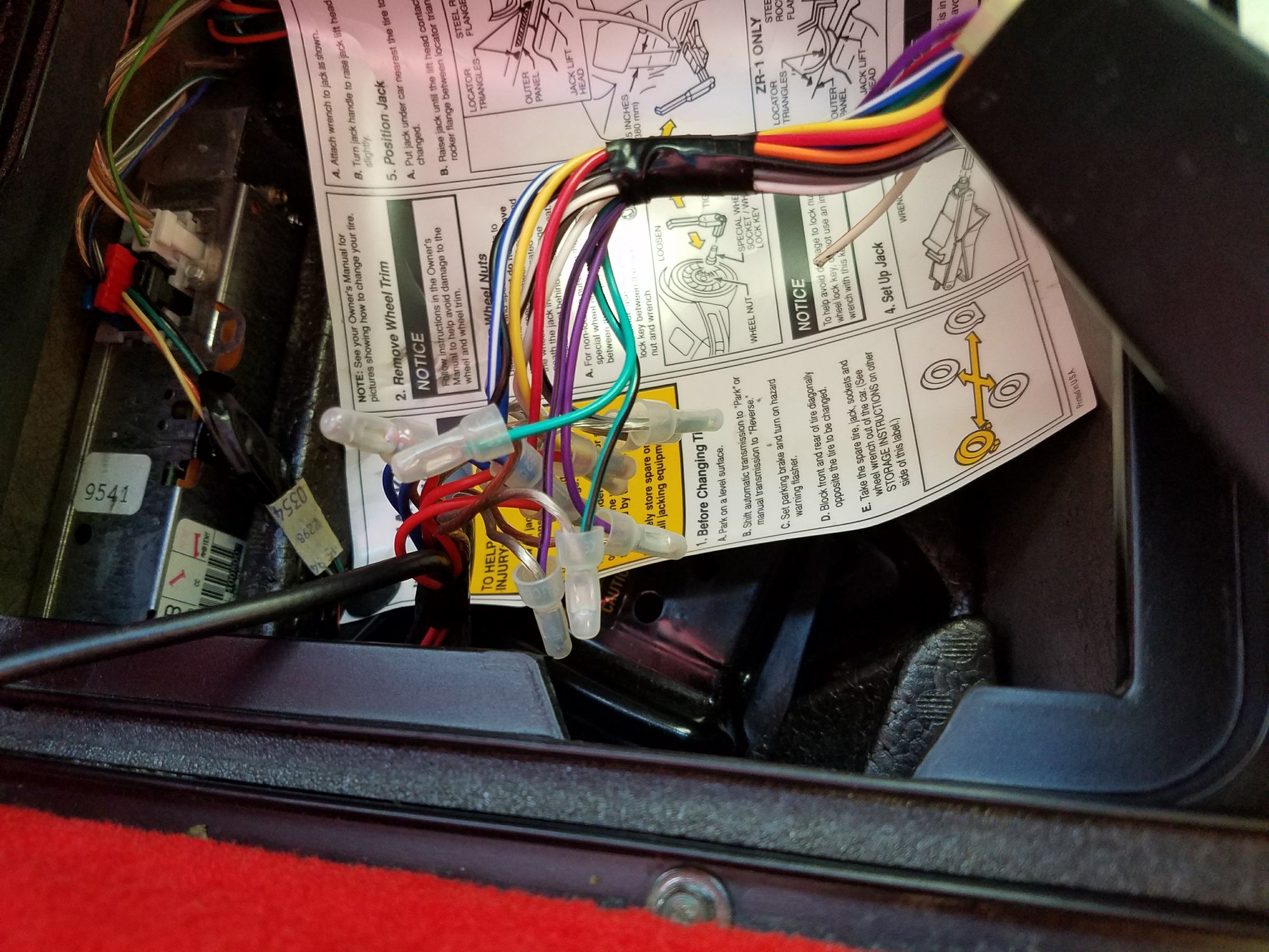

So while going over the car,, i was looking to see if i have a jack and stuff, i found where the receiver is located and i also found this thing...a PAC OEM-1 factory interface thing.... it appears to be wired into the harness, but not plugged into anything? and there's the antenna coax wire as well...not plugged in....so i'm confused as to what i should do with it...the radio seems to play great, sounds good but i don't know what the factory sound system sounds like...i ordered a new GM antenna which is on the way....i was going to try and just unplug the rear speaker and see if the hiss goes away.
Should i leave this in or remove it and get it all back to stock...???
the black coax wire is an antenna connection but it's not plugged into anything
this isn't plugged into anything...

My guess would be that the previous owner had an aftermarket stereo installed and used the PAC interface to match up the non-Bose unit to the factory Bose wiring. Then before selling he removed the aftermarket stereo and reinstalled the factory Bose without removing the PAC and didn't return the wiring to stock.
