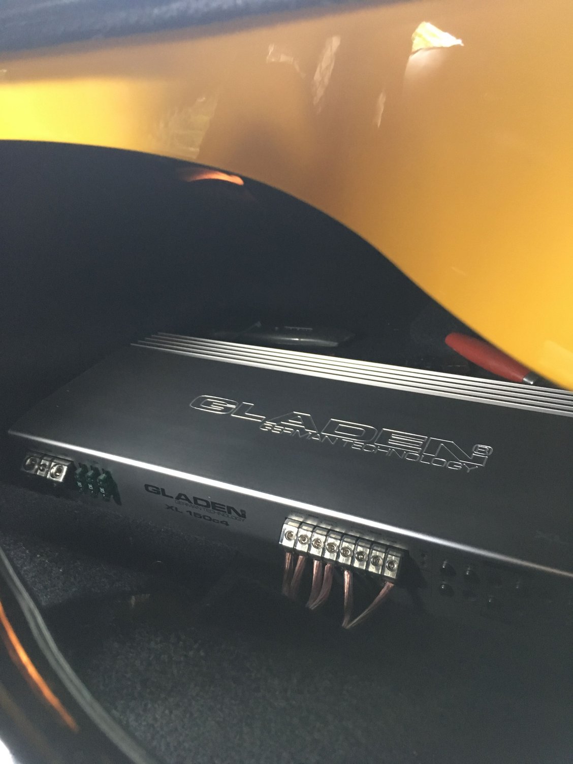

Maybe this can give some ideas, I just rebuilt my convertible with all new stereo and ripped the Bose out, it is very tight where the roof is coming down but i did get the Gladen 4channel amp bolted to the floor on a glued wooden 1/2 inch board it just clears the roof.

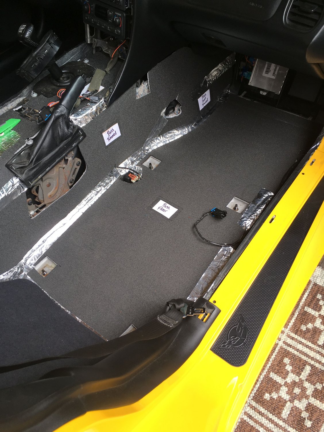

Whole car have been sound insulated including the doors, it is a good upgrade campared to Bose system and makes the car more modern.

Top down not so good bass there the door speaker setup and insulation and sound deadening build up of doors is vital for a good performance, if you like bass i would defenitely go with two corner subs if you have the money.
I did change all cables also there is place under door - floor, there is a small hatch to get acces to cables through door but be careful to place and hang cables out of the window mechanism if you do this, i trashed one of my filters thanks to sloppy install.

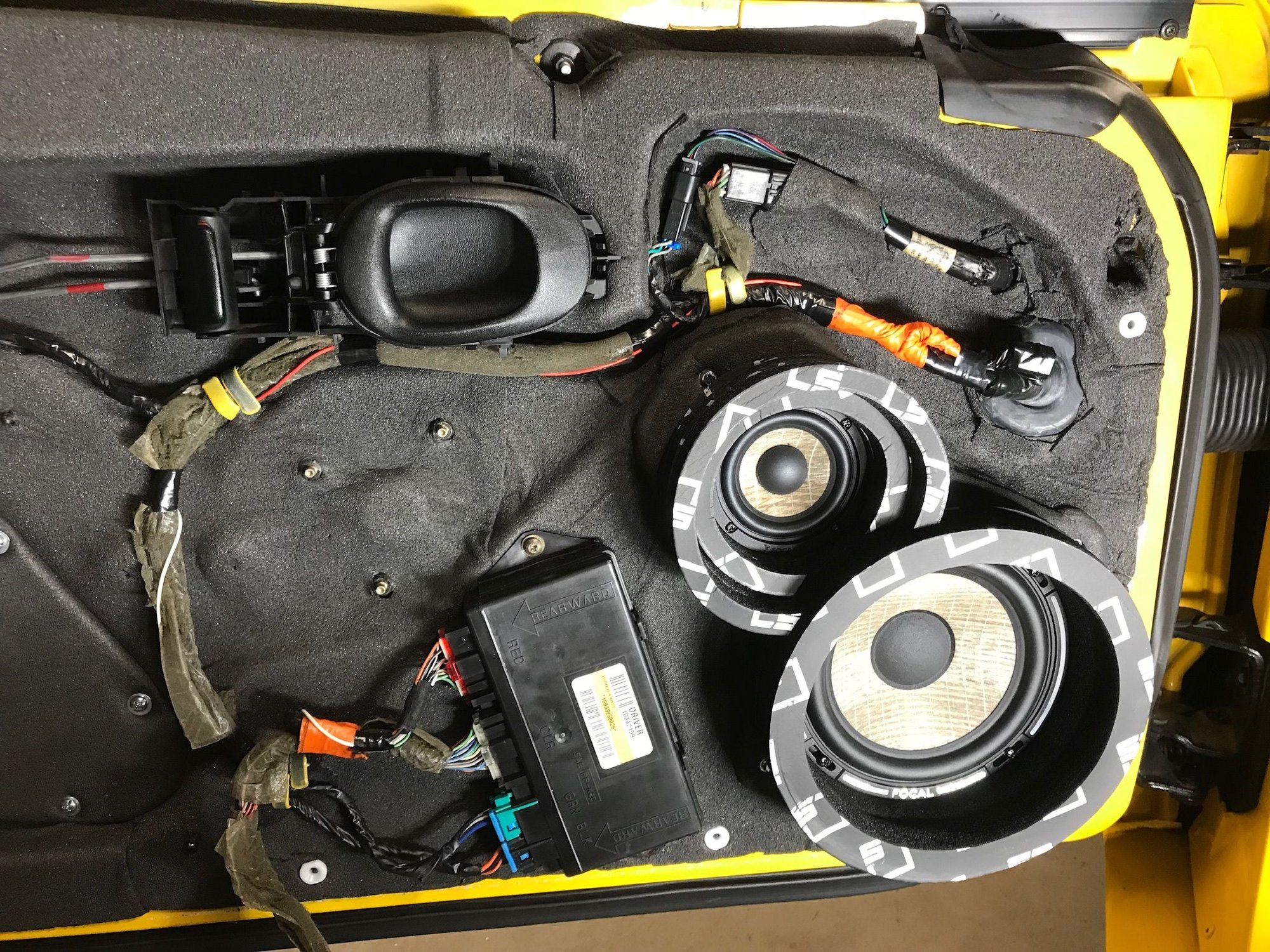

Well, here is a quick update and teaser photo! My baby has been down since September with this audio install! I completely missed the entire foliage season in New England and the local Corvette Show which I won last year. It is taking a lot more time than I anticipated but since I’m a perfectionist I can not rush it just to hear what it sounds like! I finally reassembled the car and all the wiring is complete. I now have to finish the skeleton of the amp rack before I can complete the connections to the amp and fire it up! I also need to finish the beauty panel to finish off the amp rack and fiberglass the tweeters in the A-Pillars. Unfortunately we got 6” of snow today and it’s now freezing out which doesn’t make for the best conditions in my garage for woodworking, fiberglassing etc... so I may or may not even be able to hear the fruits of my labor until the spring. ☹️ I will post a complete log post of my build with pictures when finished next spring! If I get a chance to hear some early results I’ll update you.

Bro! You can't give us awesome teaser pictures with Focal Flax's and an amazing install only to leave us hanging. Finish comments or ban!
