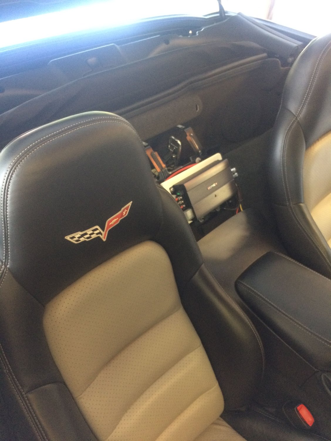

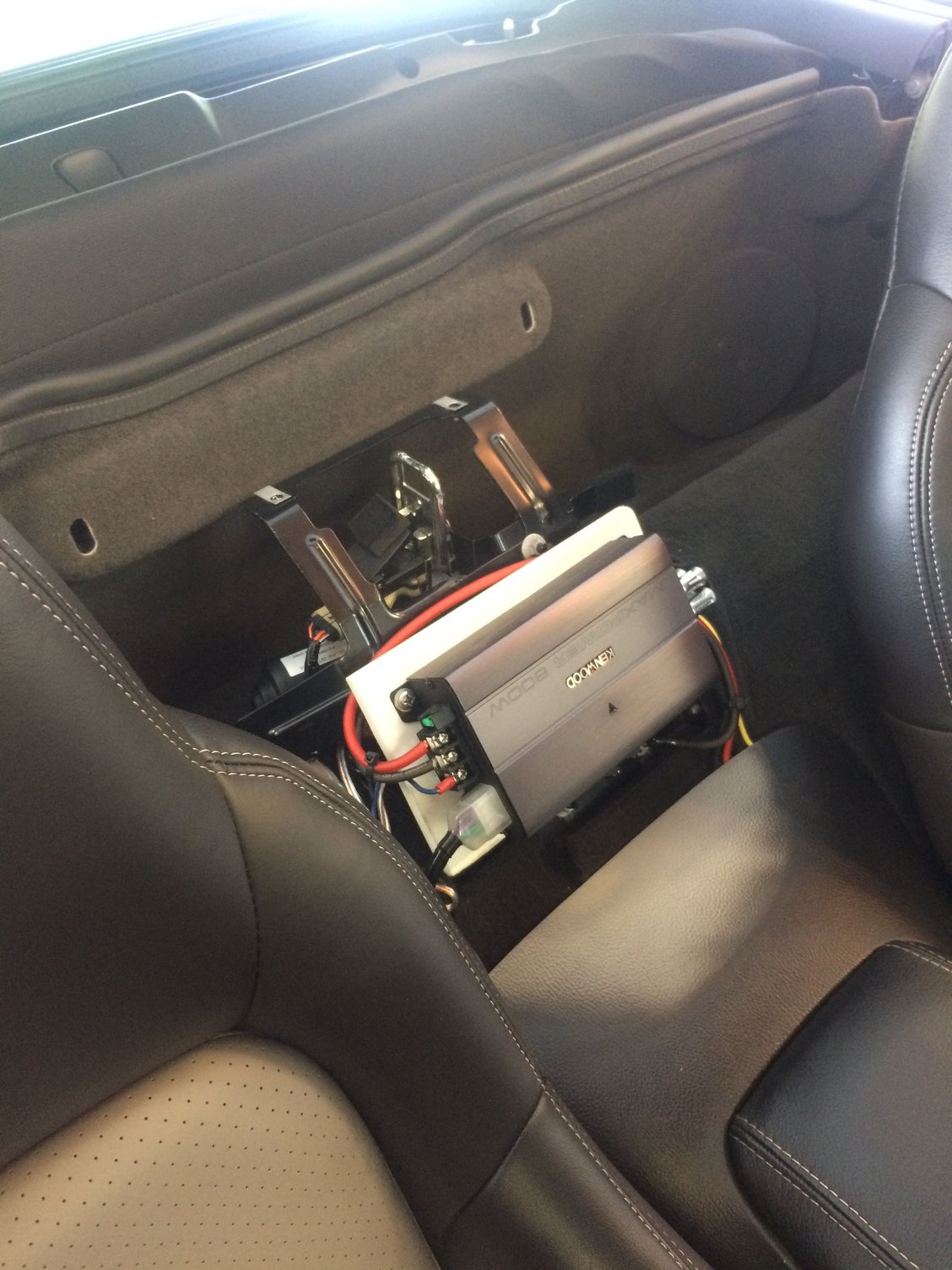

On the C6 the satellite radio antenna is located under the waterfall. I removed the antenna and used a piece of marine plastic board from West Marine to mount the amp on the existing bracket. On the C5 there is a lot of hollow space under the waterfall and that location males it easy to run wires under the center console. I also included a pic of the Kenwood subwoofer mounted in the trunk. You may want to go to the double din size so you can add front and rear cameras.

That looks really cool! Now I have to open it up and look inside to see. Any problems with heat inside it?

Waterfall is very easy to remove. That area is not as sealed up as it looks so there is some air to circulate there, I believe more than would be where the factory amp in the passenger footwell is located. 3 hours blasting tunes with the top down to Carlise and no heat issues!
Dr.Don,
Let me compliment you on doing that amazing setup. I have a few questions.
I have a 2008 Vert, trying to upgrade the entire sound system and replacing the current OEM Bose system.
1. What would be the dimensions of your amp? And what parts did you have to buy to get it installed under the waterfall?
2. Although the setup looks amazing, it also looks scary because I wouldn't want to mess up my water fall area, since it locks the top down. I want to make sure I don't mess up with the top. Some of us aren't that mechanically inclined, so what recommendations do you have?
3. How do you like the self-powered Sub? I recently bought the 2 Cubby subs that do in place of the rear speakers. These are JL Audio custom subs. Although, I'm sure they would sound amazing right behind the seats, again, I am not confident about my own installation/mechanical skills. THIS is what I have - http://www.jlaudio.com/product/54216...le_%2705-%2713
4. Lastly, what advice would you offer for doing the whole re-do of the system in a vert? C6 installation would be very similar to the C5 I think, and it would help everyone who's looking to change over to aftermarket from the Bose.

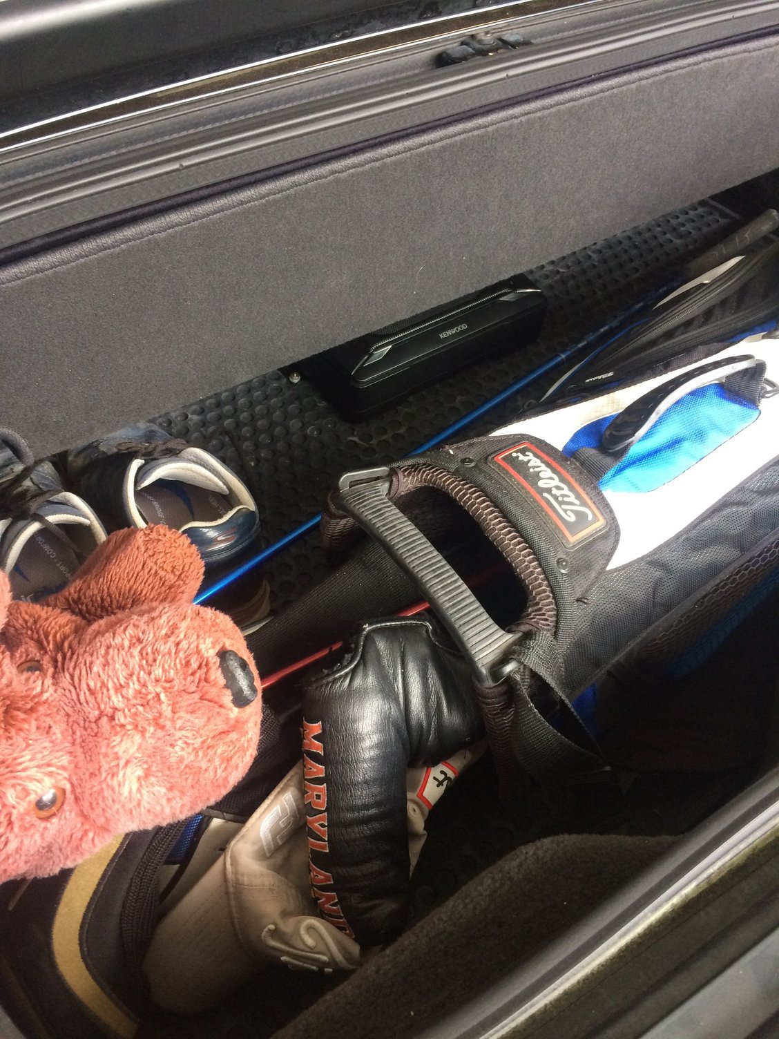

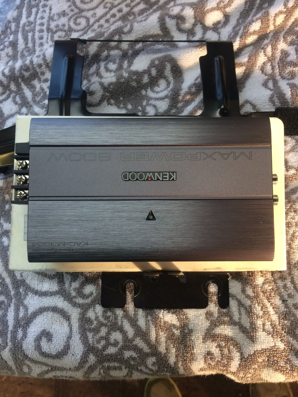

I did a lengthy and detailed post on the installation 5/17/18 that should be helpful and answer some of your questions. Not sure how to give you a direct link.
!. amp dimensions are 6 1/2" x 1 3/4" x 3 7/8". Crutchfield lists the dimensions of all their amps on their web site. I used a thin sheet of white marine plastic board from West Marine, and SS mounting hardware from there.
2. The waterfall is only a thin hollow shell easily removed with a few screws, the frame that remains locks down the top.
3. The self-powered amp adds a nice thump to the base, not window shattering, but helpful. My Kenwood head unit had RCA inputs for a sub so I added it while I was in there. I did not want to give up any trunk space (gotta be able to fit the golf clubs)

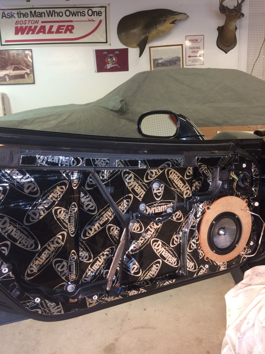

Look at Southercarparts.com for the precut door speaker mounts. Exact fit and good quality. Kit includes lower for 6 1/2" and upper for 3 1/2 or in my case the tweeter.
Used Focal Performance 165AS 2 way component speakers in the doors. Bit pricey but like them more and more. If you are on Crutchfield's mailing list they send out price reductions every week.
Dynamat door kit from Crutchfield for insulation. I just did the doors. I think it helped.....no rattles now where I had some before with certain notes.
