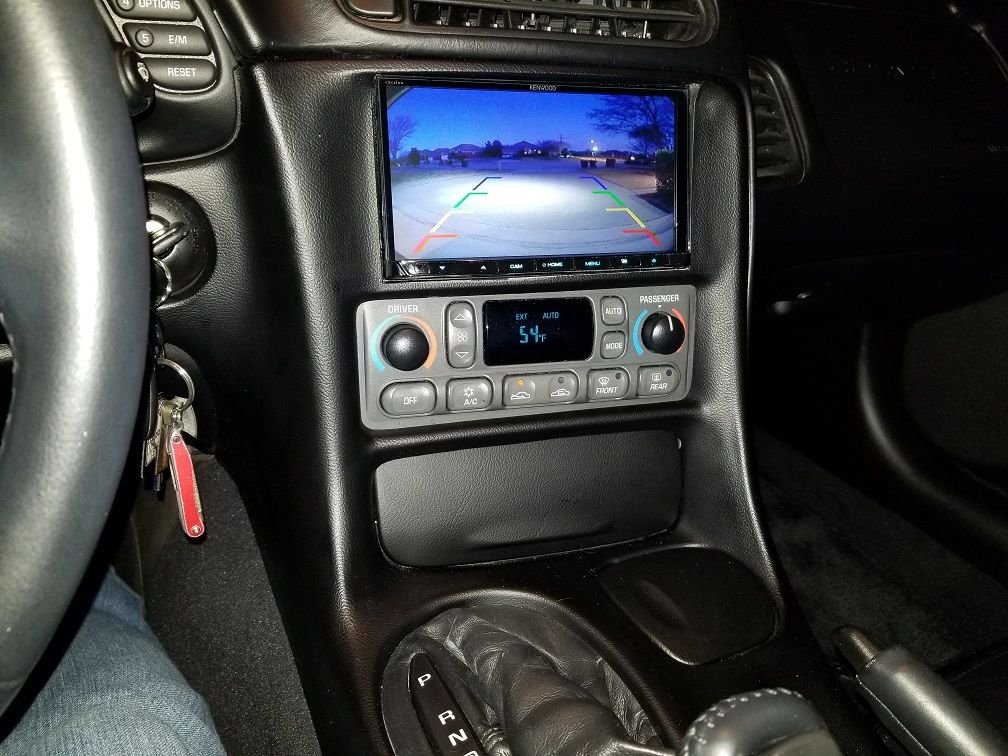

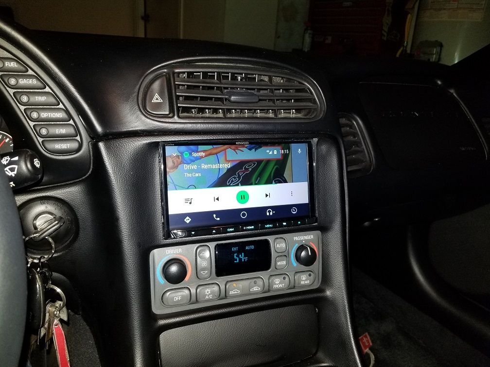

All's well that ends well, I guess. Sure could have used my time back and having this all done right the first time. Apparently it *is* the DDX9904S model. They just had it packaged in a DDX9903S box for some odd reason. Camera is installed now, too. I'm definitely liking the new head unit.
Spotify...
Waze...
Camera...
