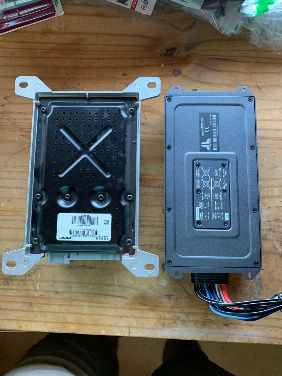

Bose amp on left. JL audio amp MX 600/3 on right
Amp installed in factory amp location.
Top view of Bose amp along side the JL
I am in the process of installing a complete system in my 2013 C6 convertible. I just completed the Morimoto headlights and eagle eye tail lights.
First. Component I replaced was the stock Bose amp.
i chose to use the JL audio MX600/3. It was a great fit in the factory amp location. I removed the Bose amp and traced ot onto some 1/4” ABS plastic. I then cut it out leaving the upper end about 1.5” longer to accommodate the mounting of the JL amp. It fit great.

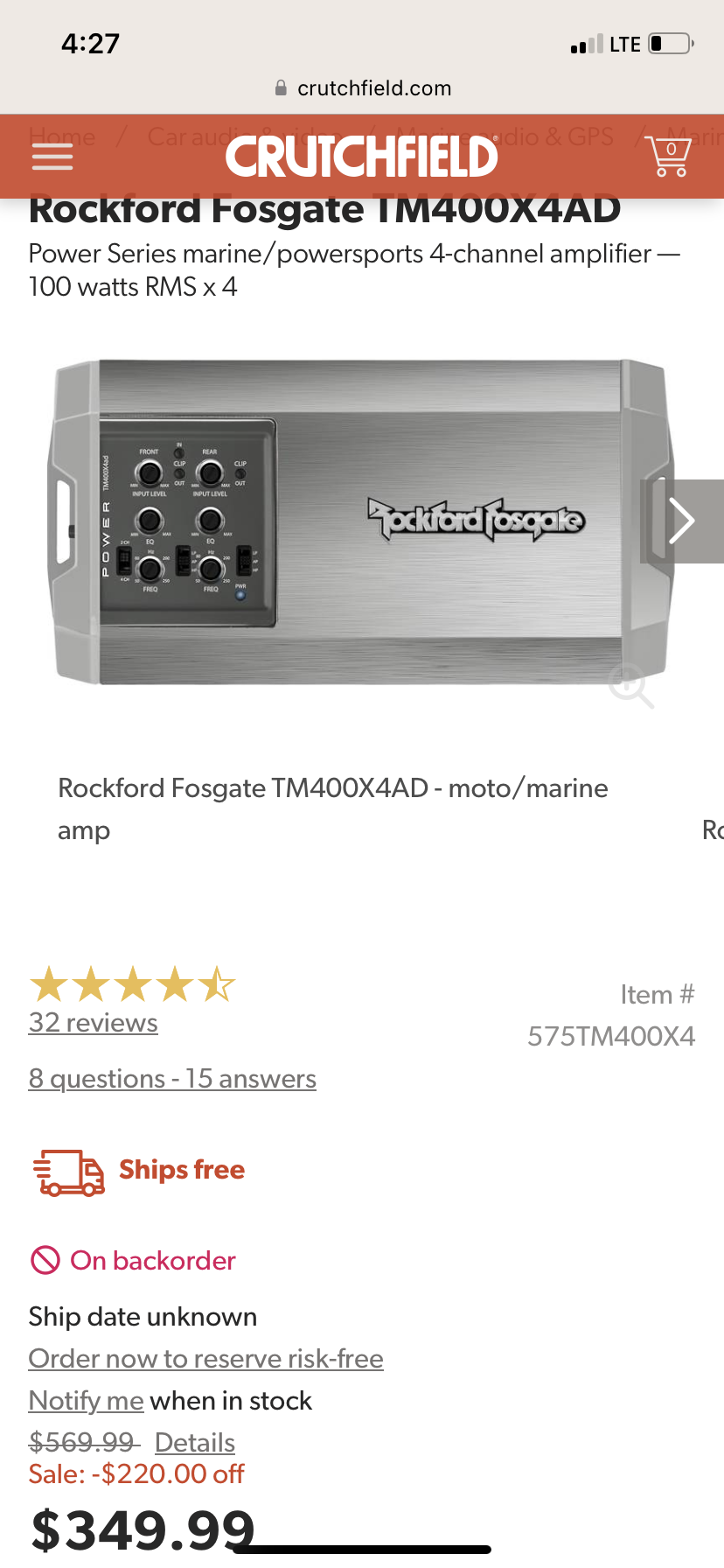

I plan on installing in that location as well. Crutchfield has a good sale on these:

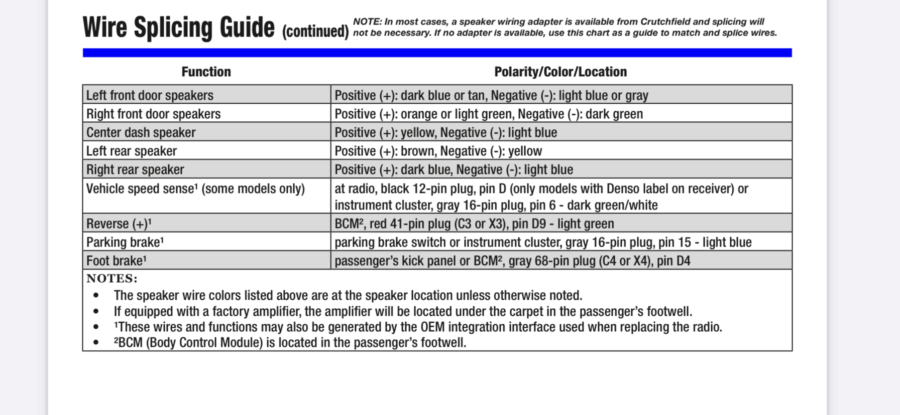

No, my plan is to use the crutchfield wiring diagram to find all the low level outputs from the Bose/Nav head unit and bring to amp. I wanted a compact amp to mount where the Bose amp is to minimize the power and signal wires (for both loss and minimal car disassembly.) JL Audio C2 6.5 components in the door and JL 8” 8W1 subs in the rear cubby. I didn’t want subs in the door as the Bose cause vibrations. Plan to do some sound dampening in the doors.
Tricky part is designing the brackets for the amp. If I do like the OP, my settings will be facing the floor. I plan to take pictures.

Ok, had to take picture
once i get the amp, I will build a bracket and send out info on how to build.

I was able to remove the Bose Amp and run the OEM head unit low level inputs to aftermarket amps with no issues. Steering wheel controls still work, chimes work. If you use the low level inputs, you do not need an integration device. I would recommend using the signals upstream of the Bose amp.
