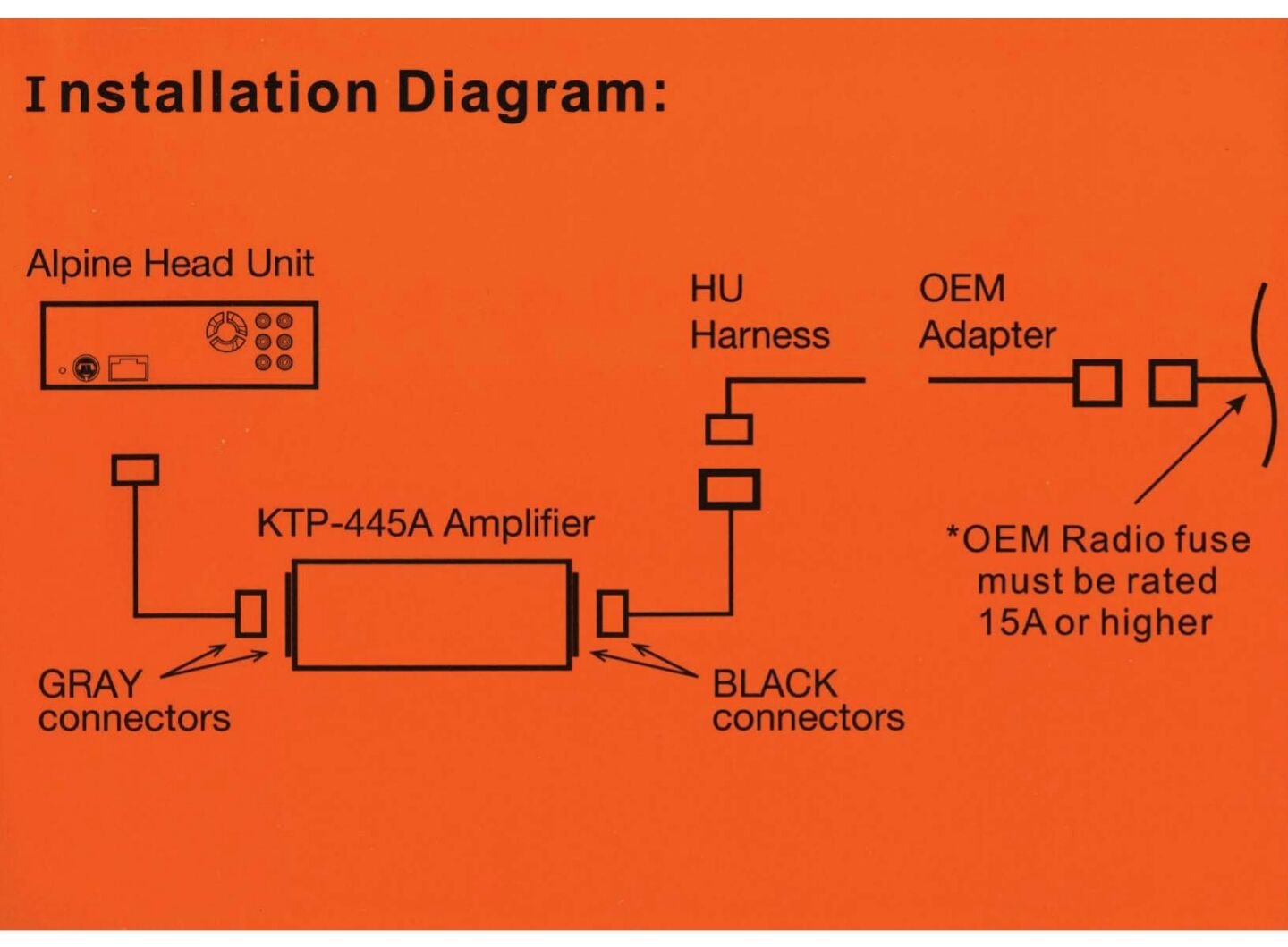

I gave an "educated" opinion based on the information at hand. It was meant for a headunit requiring a 10A circuit and an additional amp requiring a 15A circuit.
Just out of curiosity, I looked for more information regarding this specific device. It is an add-on amp specifically designed to complement the same manufacturer's headunits, and it is inserted "in-line" with no independent connections. Its harnesses and connectors are designed to mate with the headunit's, and what's more important: the recommendation to use a 15A circuit is intended for both, headunit AND amp as a combo.
That changes everything. There's no need to look for a separate 15A circuit just for the amp. It's simpler to do it as per the diagram above and, as mentioned in the quoted posts, probably it will never blow the 10A fuse because of the headroom that's built-in in the manufacturer's recommendation (specially at moderate levels).
For peace of mind you could take a reading of the current it drives during normal operation before deciding to keep the 10A fuse or bump it up to 15A.
