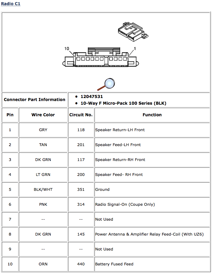

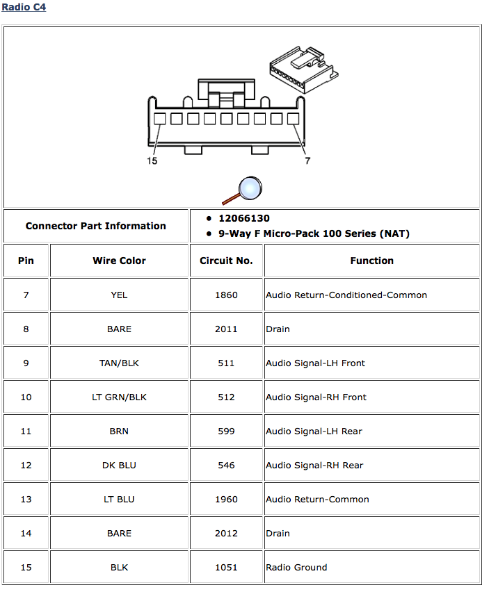

These are the OEM Bose headunit's 4 connectors:
