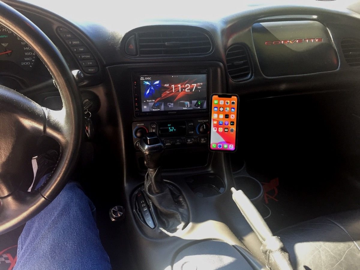

I just put this in my 1997 and could not be happier. The Kenwood unit is on sale right now at Crutchfield.com for $399. It has CD, DVD, BT, Rear and front camera inputs, Apple Car Play or Andriod Auto, and much more. You would need to replace you dash kit due to a bigger unit. ($250) I went ahead and added a back up camera and small sub woofer while I had it all open. A bit of a job but well worth it. As far as GPS goes, having Apple Car Play / Andriod Auto depending on what kind of phone you use, it takes the map off of your phone and puts it on your Stereo screen. Works great and is always updated. And I am using my bose speakers.Good luck
Kenwood Excelon DDX6906S and a Metra DP-3021B Dash Kit

Sounds like you think I am the original poster (?) If not, forgive me for reading it wrong. Anyway, yes, these are great units for the money. I have the same one in my truck. And had another (very similar) in the C6 I had. Might as well get a BU camera while you're doing it if you don't have one already. I also added the sound ordanance sub woofer from crutchfield while I was doing it. It's not a big one but fills in the sound really good. Good luck with it.
Also, if you don'r already have a phone mount, I got mine from Pro Clips. It's awesome. It just snaps on where you see my phone. Then got their magnet mount to hold the phone to it. Work great.

Saw your pic and though that phone mount looks great and sound ask but got sidetracked. I’ll look into it ,Thanks again.
