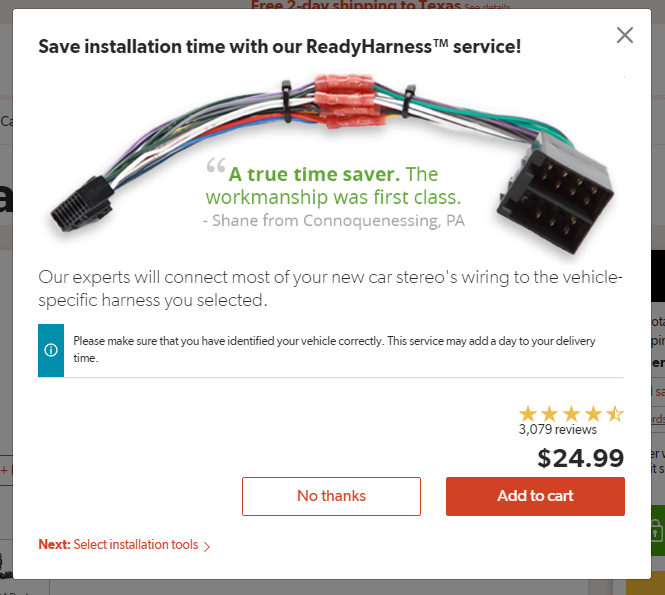

When you add the equipment to your cart, look out for this offer and make sure you add this also.

OH! Yes, you're right. I did see that and didn't fully comprehend what they were offering. That would have saved me an hour. However, you still need to take a couple apart if you want to ground the brake wire and wire in the backup camera trigger.

Thanks I did that. Seems like potentially a big time saver for on $25.
The Crutchfield rep said he believed the wiring harness would be full plug and play with the possible exception of some speed sensor for some versions on the stock radio. I hope he's right.

Compared to the time to power, install, and run wiring for the cameras, it won't save any time at all.
