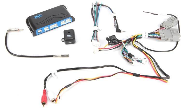

The newest PAC RP5-GM11 and the PAC GM1A-RST both have what's called short press and long press functionality where you can program two functions to one button depending on how long you hold the button, for example, on my phone answer button a short press will answer the phone if I get a call, if I press and hold the button (long press) it'll activate Siri in my head unit for voice commands, with mine I can have both short and long press functions on any of the buttons of my steering wheel. So what exactly are you referring to by you want something to work with "Bluetooth" also, what do you want to accomplish ? This is what the newest PAC RP5-GM11 interface looks like, if it doesn't look like this then it won't have the short/long press functions.

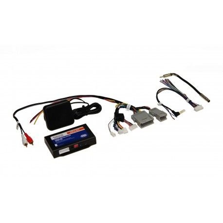

This is the old RP5-GM11 that DOESN'T have the short/long function.

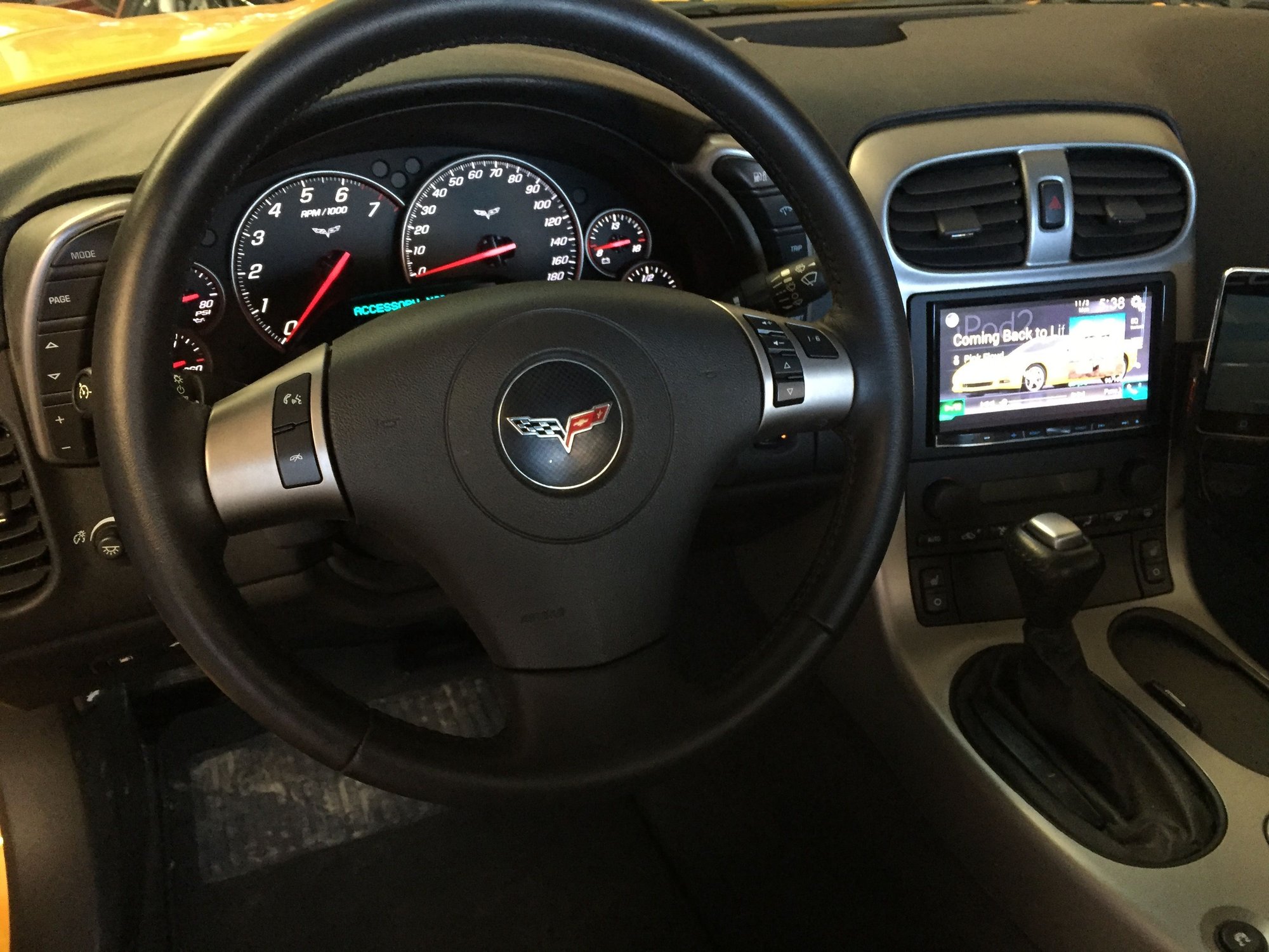

So there again you may have the ability to do this depending on the interface you have, one other question, does your current steering wheel have buttons on both sides of the steering wheel such as this one ? Or are they only on the right side ?
If yours only has the buttons on the right, then getting a newer steering wheel with the buttons on both sides, the buttons will all function, however as I noted above you might be limited on the functions you can program them to based on your interface. One other thing I had with mine, is that the phone buttons would always default to OnStar, so to get them to program they way I wanted was I had to disable OnStar, I did this by pulling the OnStar fuse in the fuse panel under the passenger side floor board which didn't bother me because OnStar is no longer supported on my car anyway, once disabled I was able to program the buttons anyway I wanted.
