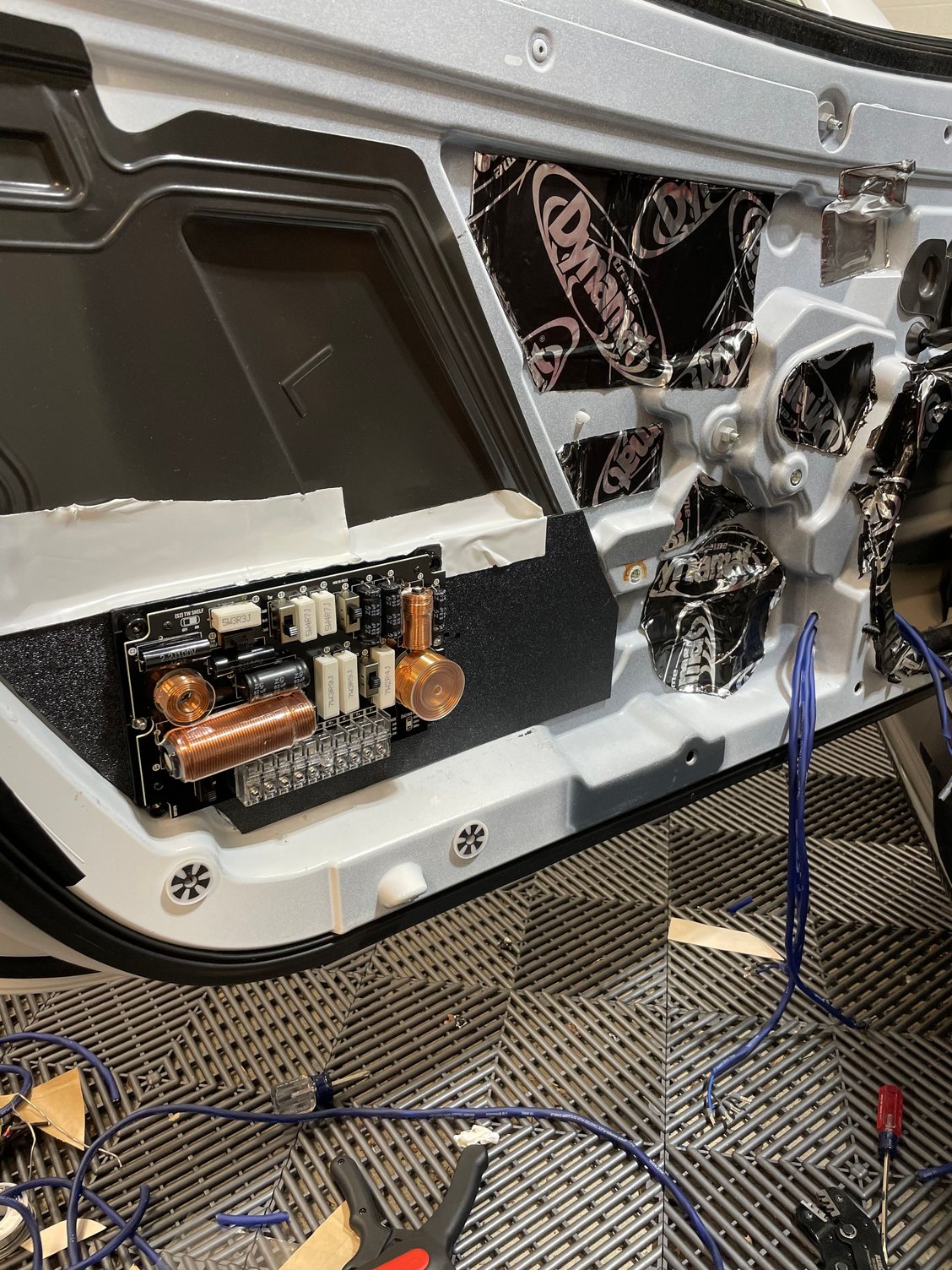

3way setup where are you putting actual individual drivers....the locations
Old Jul 1, 2021 | 06:00 PM
Reggie927's Avatar
Reggie927
Joined: Apr 2018
Posts: 194
Likes: 27
Old Jul 1, 2021 | 07:26 PM
VinceC5's Avatar
VinceC5
Joined: Sep 2004
Posts: 2,847
Likes: 439
From: Spring Texas
12 and 13 model have a factory dash tweeter. So mine had 10" midbass in factory door location, 3.5" mid in door panel location, and 3/4" tweeter in dash corner locations. All wires ran to crossovers behind passenger seat.

Old Jul 5, 2021 | 11:13 PM
daveb91's Avatar
daveb91
Joined: Dec 2019
Posts: 266
Likes: 48
Was talking about Reggie's C7 Focal setup
Old Jul 5, 2021 | 11:15 PM
daveb91's Avatar
daveb91
Joined: Dec 2019
Posts: 266
Likes: 48
Tweeter in dash or in the 3.5 door spot.. thanks
