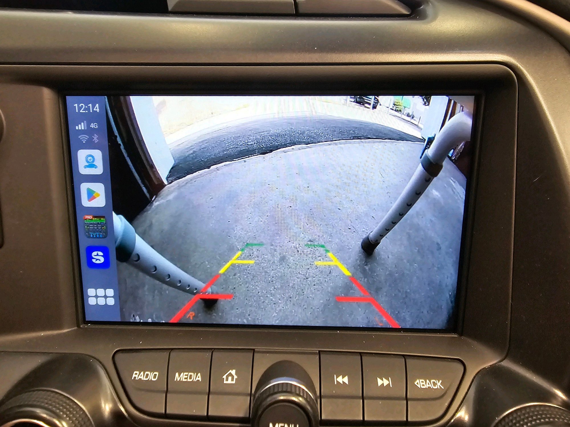

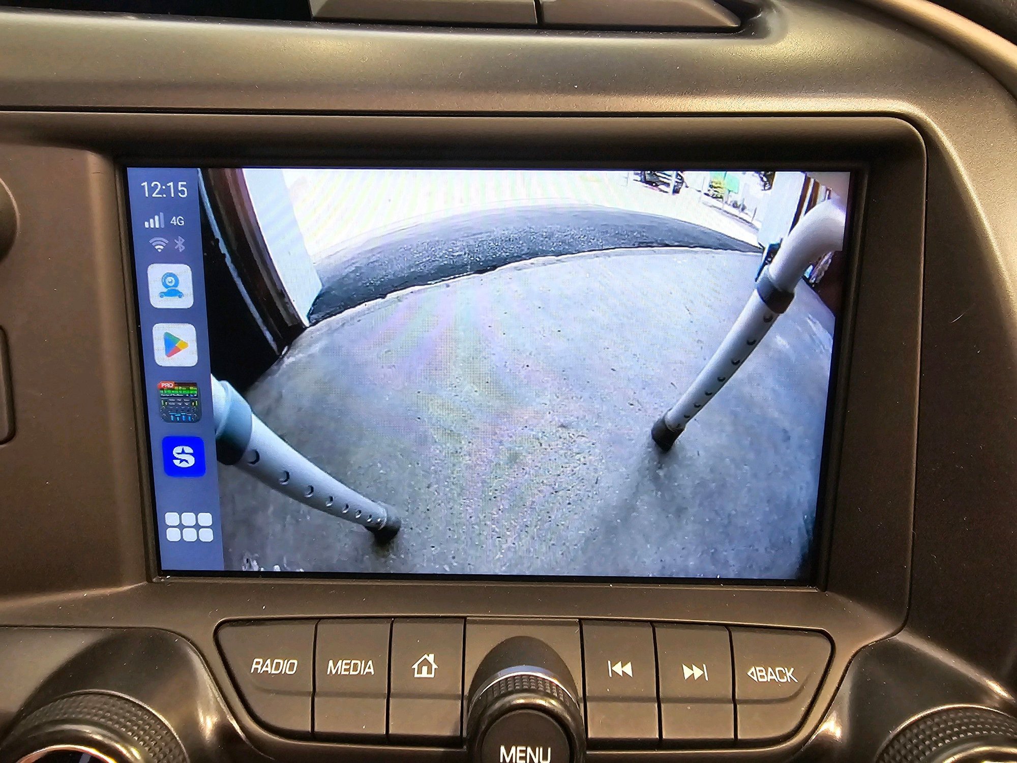

Finally got it all sorted out. I don't have it mounted yet, I want to remove the front bumper to do it. Need a rainy day for that.
JoyTrip is the APP.
With guides.
Without guides.
