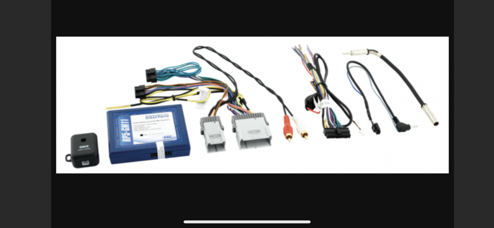

it’s this kit, the older PAC RP5-GM11.
soooo one thing I didn’t realize til a few minutes ago.
The memory wire. The way it’s wired up, there’s one going through the interface box into the radio… and a second bypassing the interface box and going straight into the radio. I’m guessing maybe this is incorrect? And it could be the problem? Which one is right?

I meant pics of it installed. A few known issues:
1. Older versions of that interface needed the additional bypass wire on the Acc circuit for some headunits.
2. Some interfaces go bad and do cause this parasitic draw.
You can do some further tests by just removing the module or just go ahead and replace with newer model from Crutchfield.

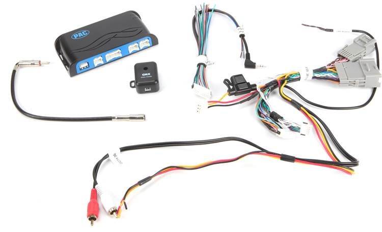

This is what the newest version of the RP5-GM11 looks like, it's got some improvements over the older version. If your current RP5 is bad, you wouldn't be the first one who's had issues with them.

And as far as your question on if it's necessary, yes it is, it's need to interface between the cars canbus system and the head unit.
