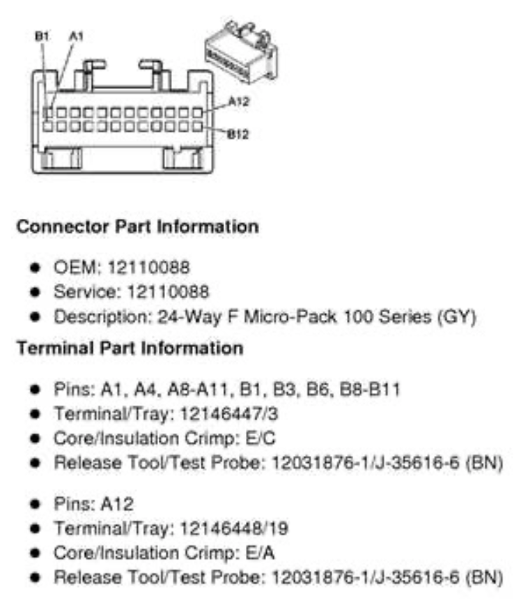

I'm not sure your car would have the correct harness for the steering wheel controls, you may have to add the three wires to get it to work, and they'll only work with a Bose or Navigation system. You could look at the pins on the main harness to the stereo. If you have wires in the two pins shown in the photo then it should work, if you don't then you'll need to add the wires.
The pin numbers for the steering wheel controls are pins A6 and A7 shown here.
If you do net a used Navigation system, it needs to be from a 07+ in order for the steering wheel controls to work with it, you'll also have to have it married to your cars VIN with a Tech 2, so it won't just be plug and play unless this is done.

No problem, glad to help. If you don't have the wires in the pins I mentioned, I can send you some info on how to add them.

so apparently I don’t have those wires 😳
so any help you can offer would be much appreciated

This will show you what you need to do. So since you have a 2008, you should already have the correct clock spring in your car, so alls you should need to do is add the three wires to your connector for the clock spring and run them to your head unit connector. Let me know if you have any questions.
