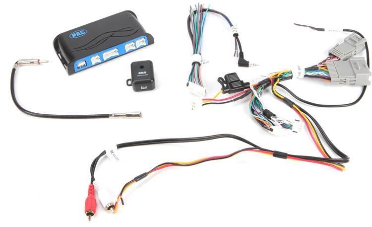

This is what the latest RP5-GM11 looks like. The older ones had a more square all blue box.

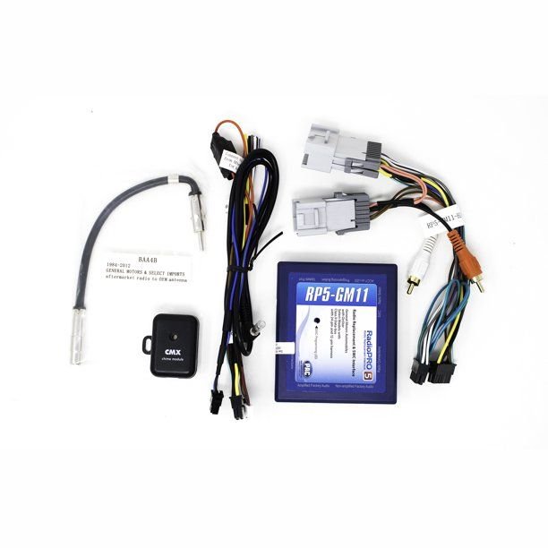

This is one of the older ones.
