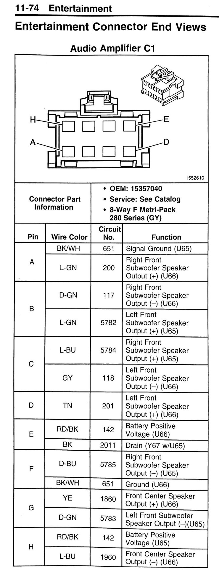

Interesting. Appears that the fuse is in the engine compartment, not the passenger footwell. I suppose I now need to find which wires from the harness are the power/ground/remote turnon? I may end up running proper wiring directly from the battery, but in the meantime this could be a great solution.
Notice the different pin assignments for Bose (U65) and non-Bose (U66) systems.
It's not obvious from the chart which pin is the Bose power ground, but there has to be one. An examination of the innards of the factory amplifier should clear that up.
