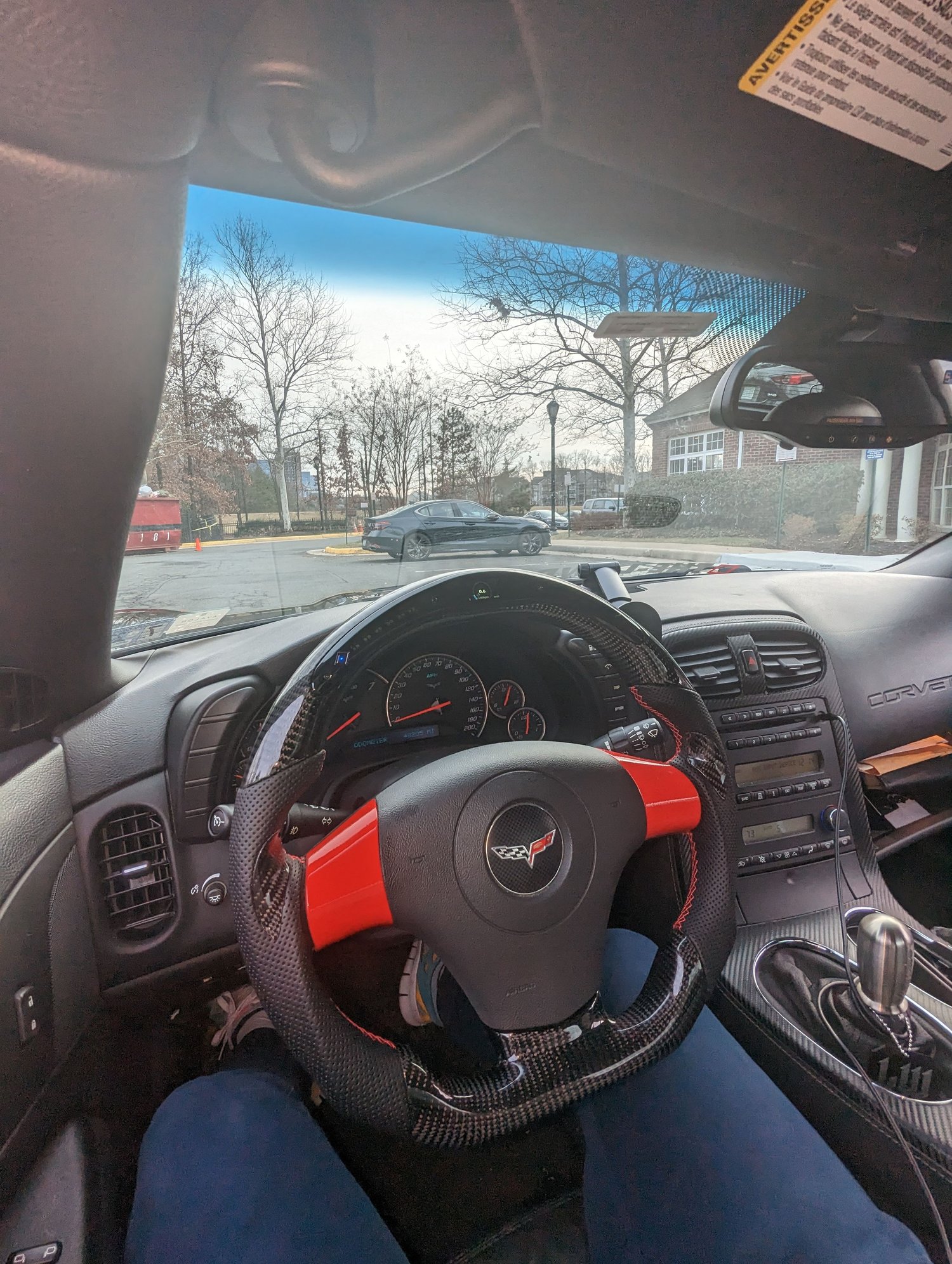

Rev LED and Info Screen Installed and Working!
Originally Posted by NBVette_Canada
What does it say to do in the manufacturer installation instructions on how to install the wheel and where to pick up the 12V source?
Manage to figure it out. I was able to find a 12V source on the clock spring harness under "12V ignition". It only powers on when you turn the ignition switch, accessory mode doesn't give it any 12V. But regardless still serves the purpose I need it do. The reason why the horn or any other component would go off as soon as I try to tap into it was because the current was finding an alternative ground. When you press the horn on your car all you are doing is completing the circuit and grounding the current. Hindsight 20/20.

post bigger pics of the LED portion
