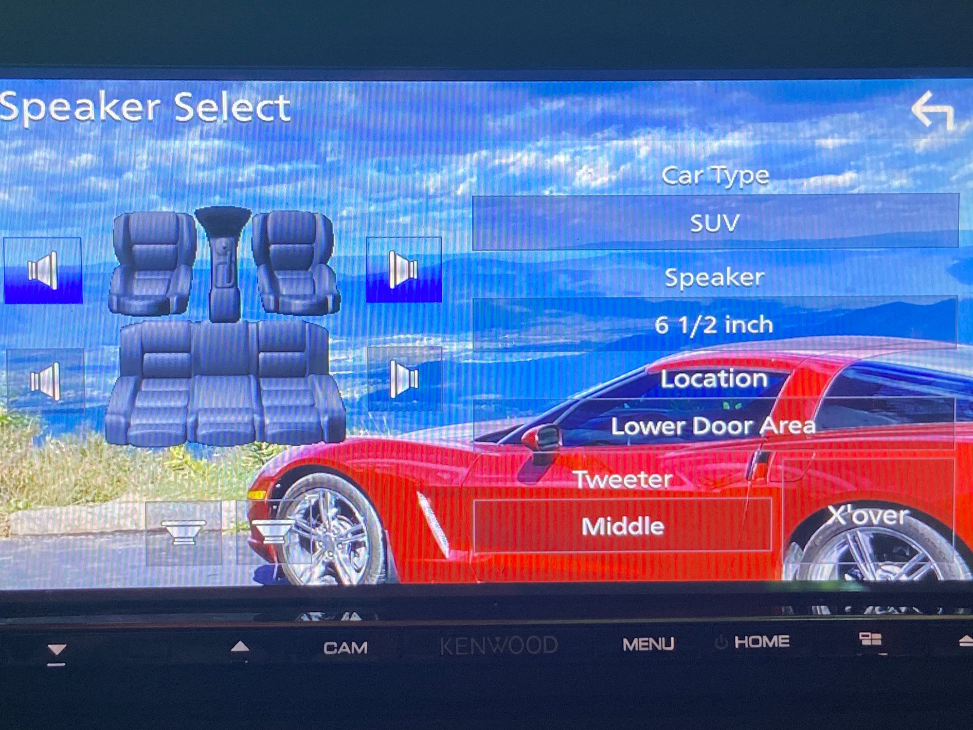

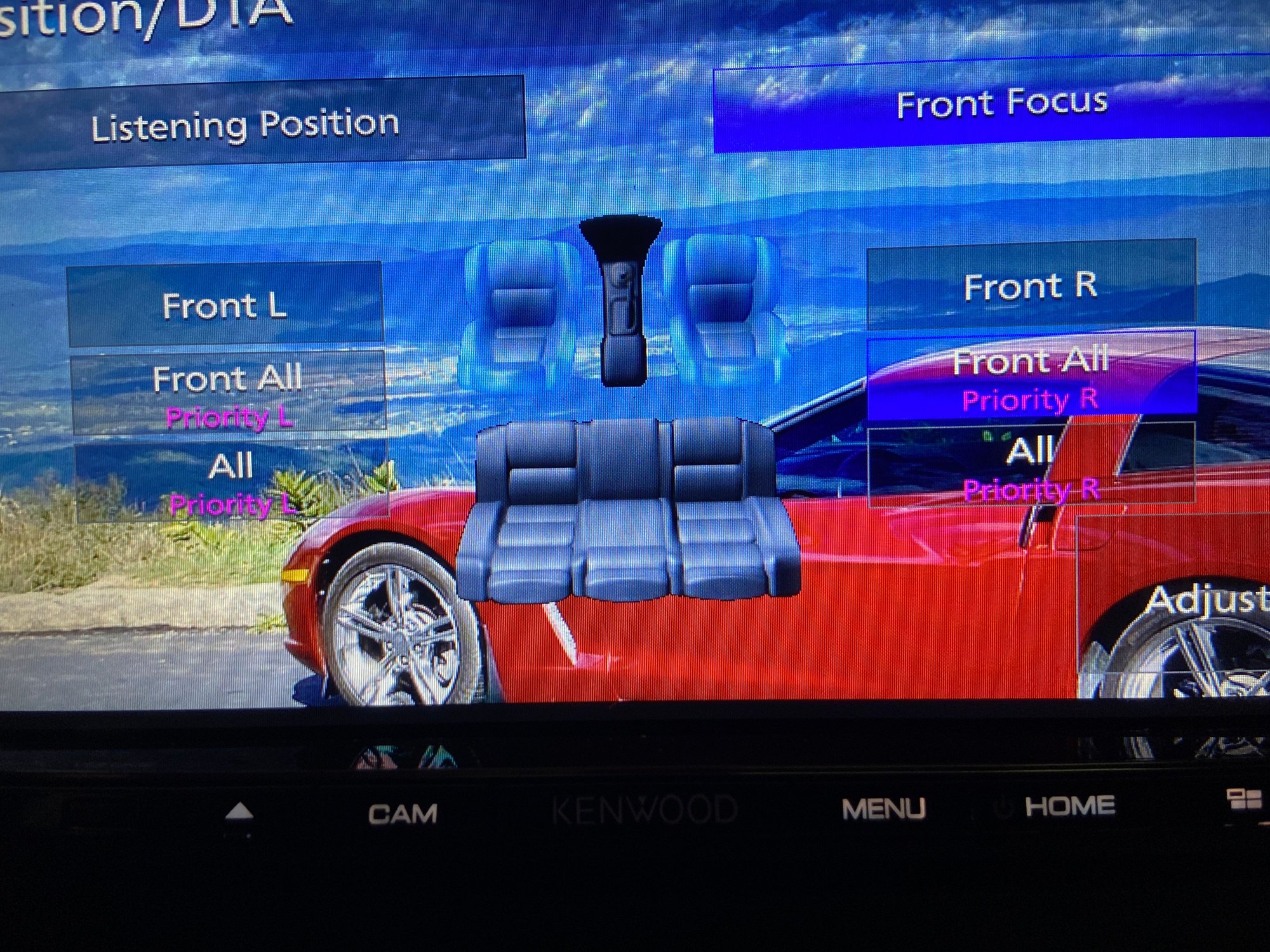

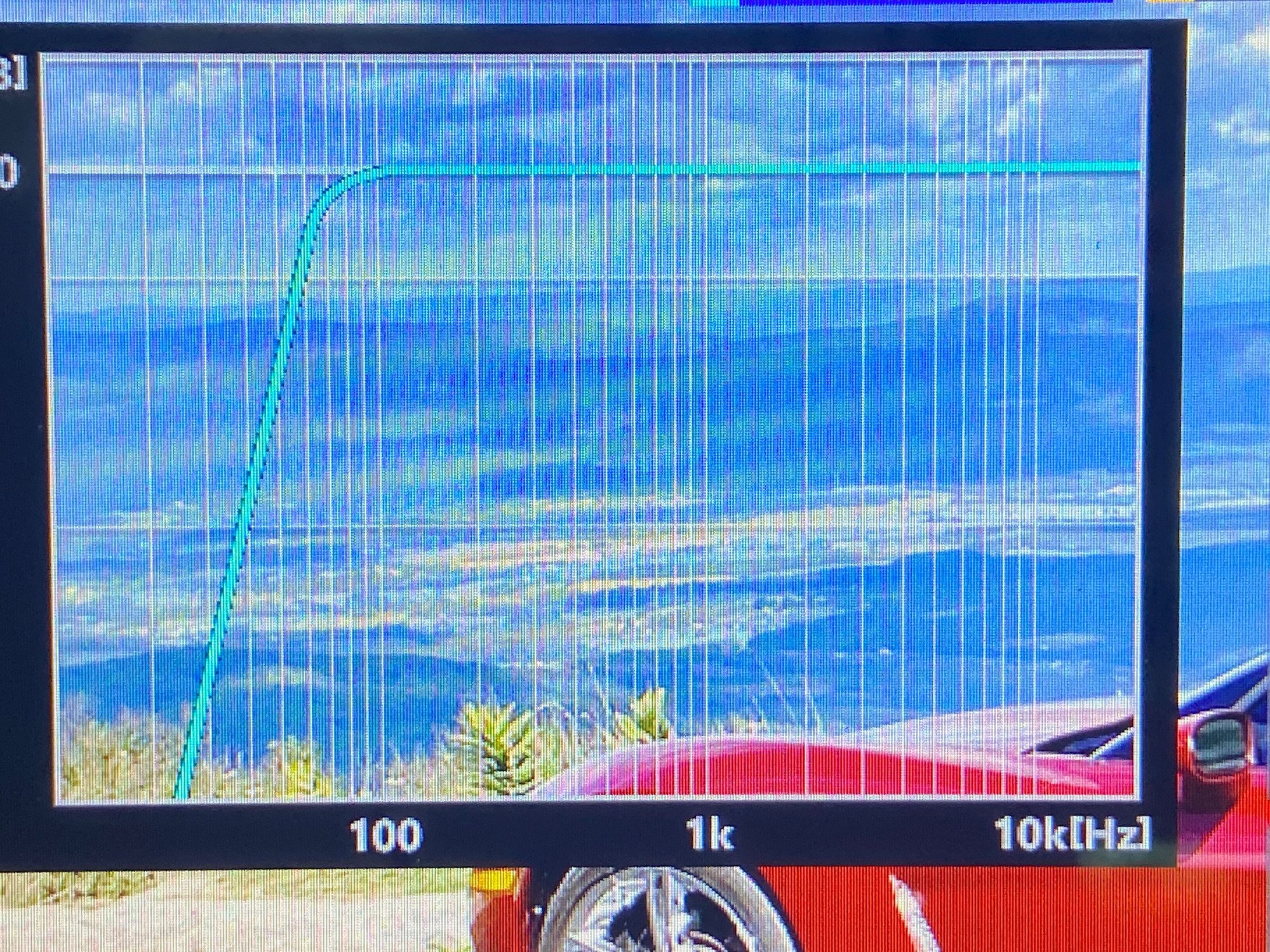

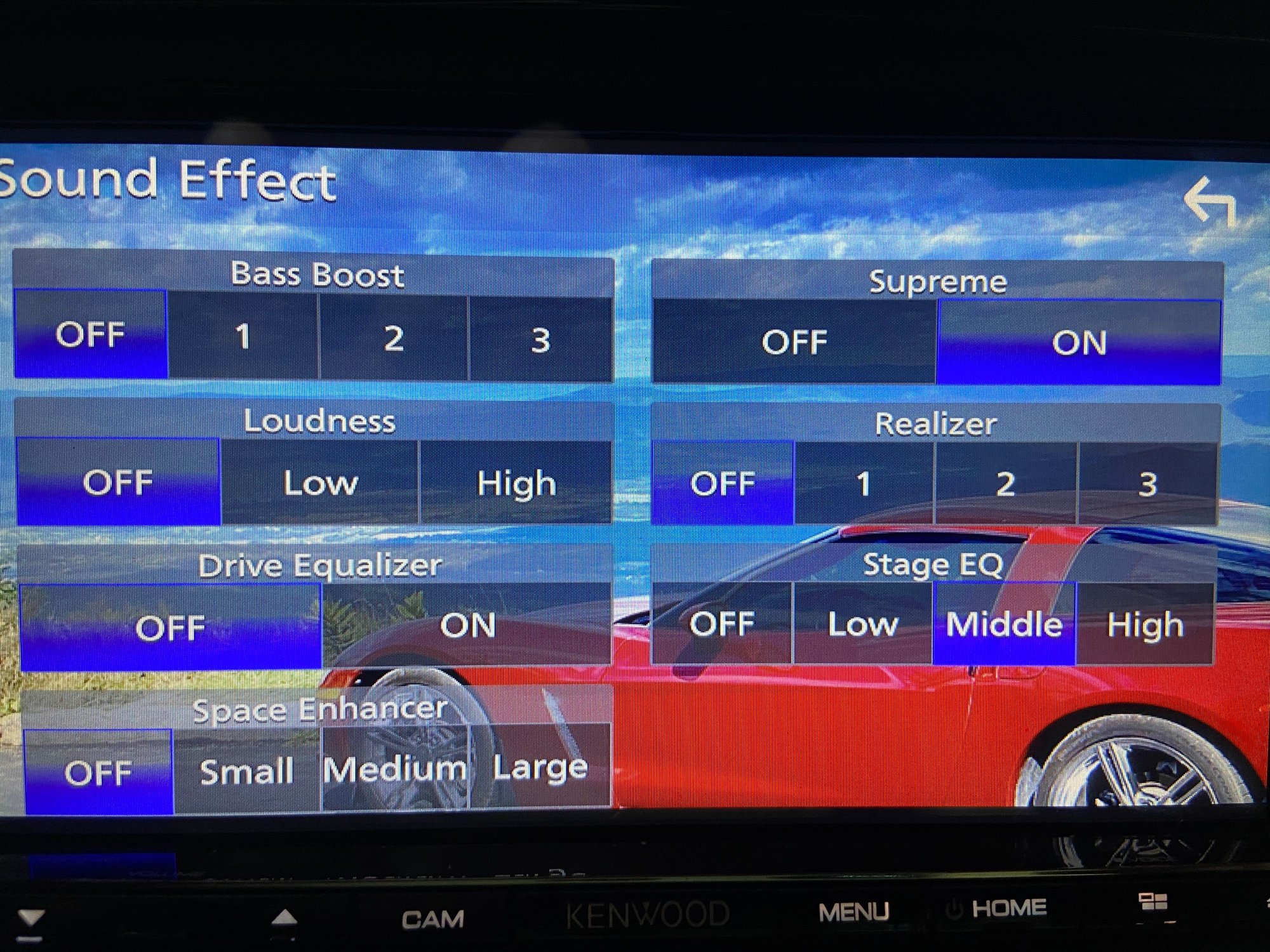

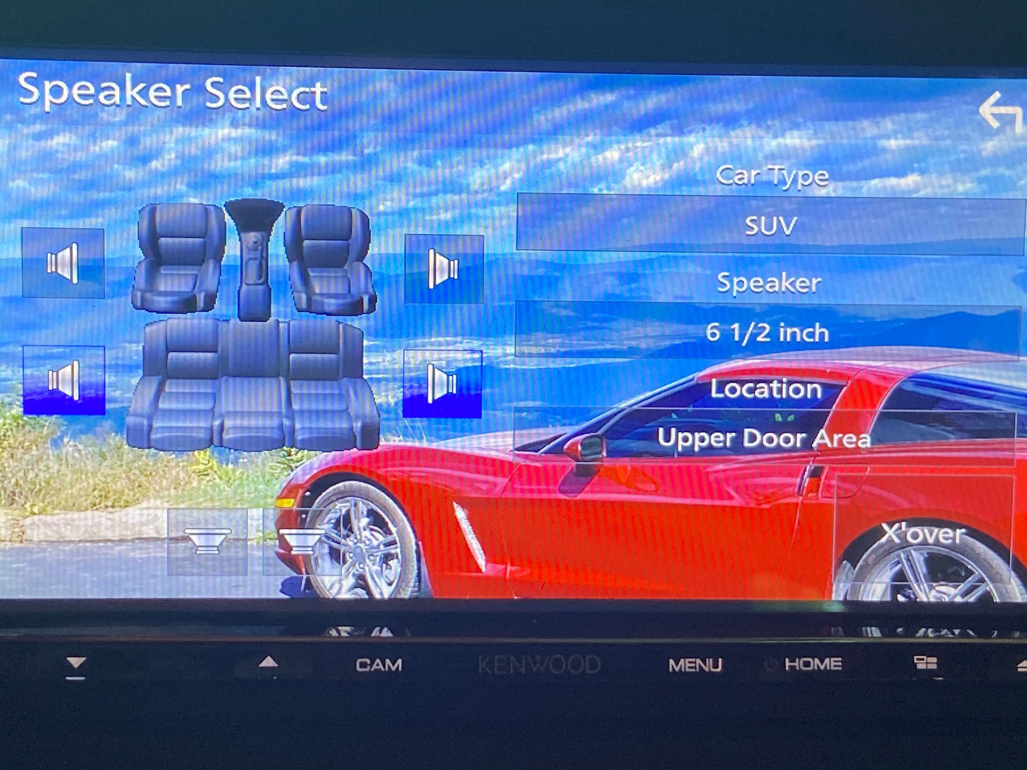

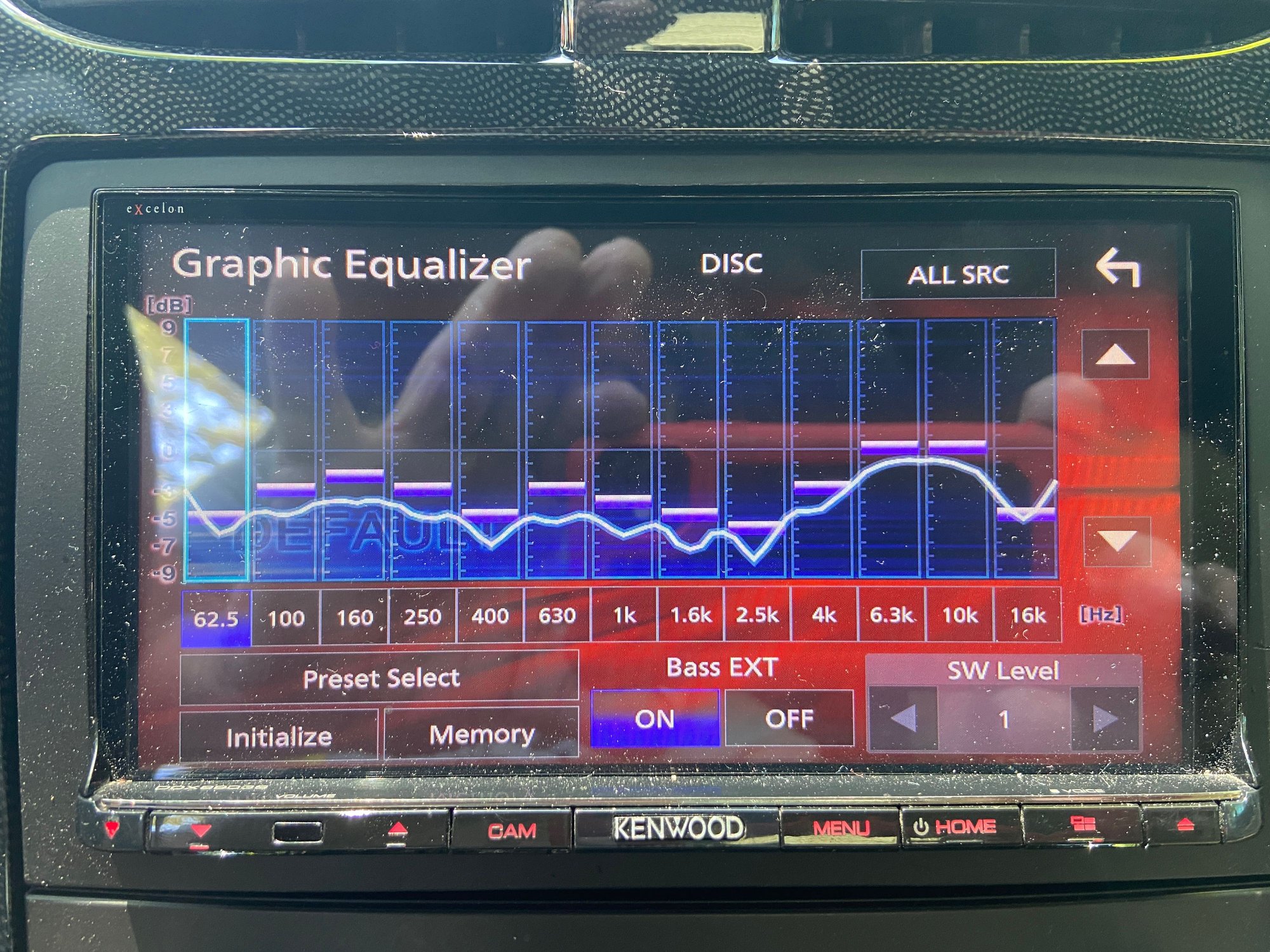

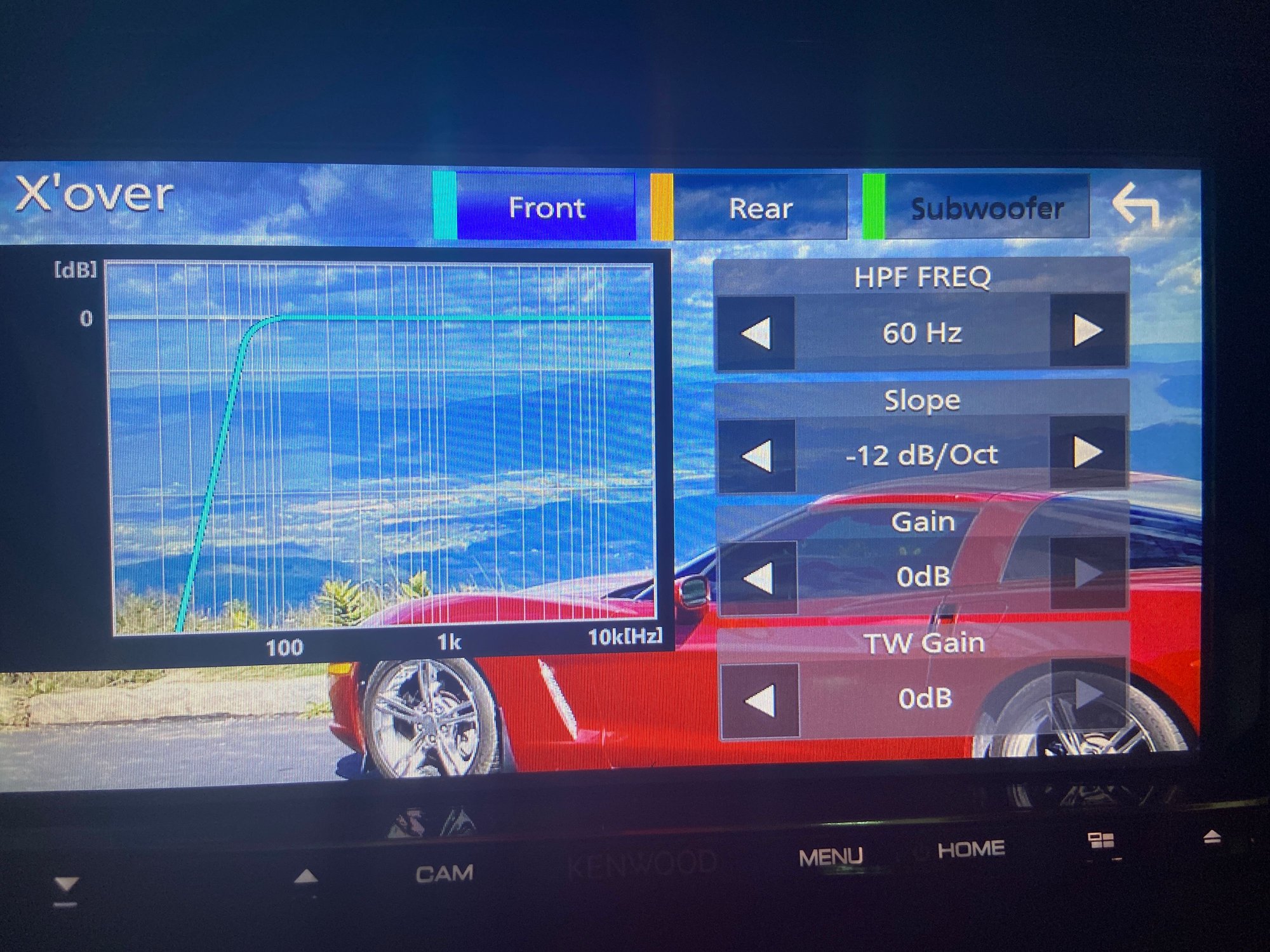

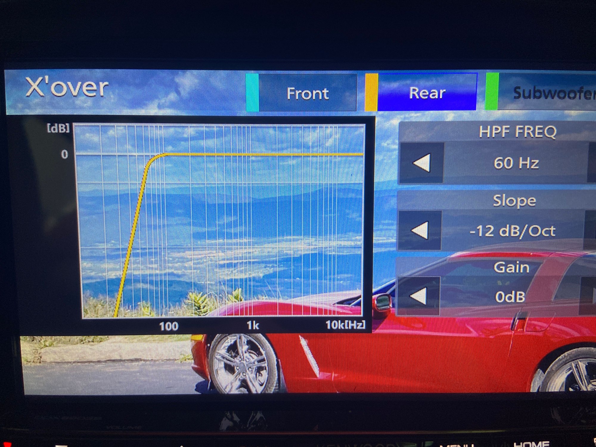

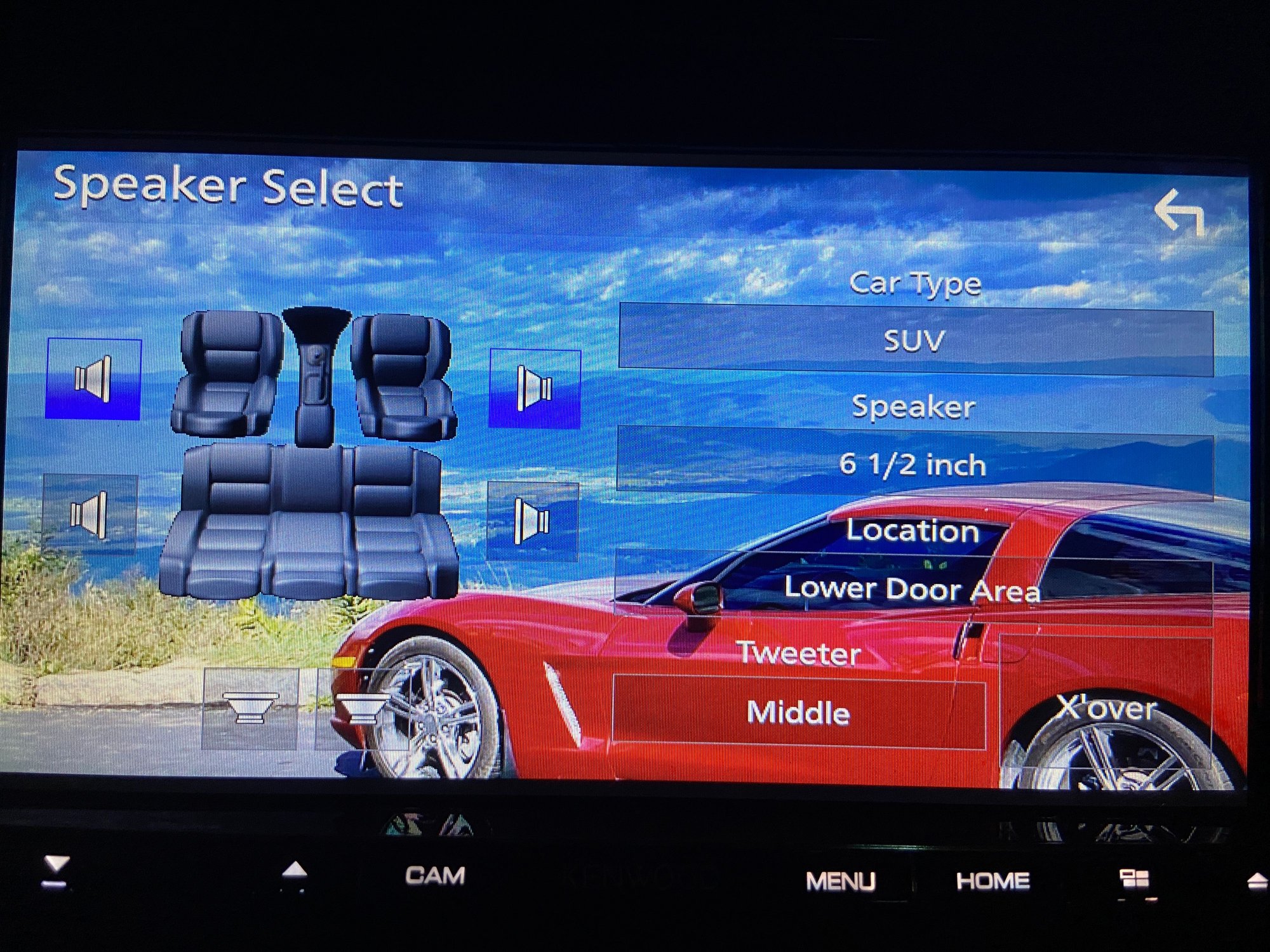

Herer are the rest of the settings on my unit that I did not include earlier. And FWIW I have th Kenwood DDX9903S with aftermarket Punch 3 1/2 P132's in the upper doors, Kicker CSC67 6 3/4 lower doors and Kicker DSC50 5 1/4 behind the seats. I removed the center dash and one of the tips that the tech gave me came after I mentioned that I really couldn't hear the behind the seat speakers. Like back in the day when the back set speakers were blasting and the windows were open. He explained that you really don't want to notice them. You should be sitting in the car as if you're are a concert and the band is never behind you. Maybe a small sound, but your focus should b3 what is in front of you and maybe even hearing the back but not noticing it. This is all I have to share. I will probably be playing around with the equalizer a bit now that he has me in the BALLPARK but if I screw it up I always have pics of his setting to get me back to square one. A place I would have never gotten to without their help.
Rear crossover
Front crossover
Speaker select front door
Speaker select behind seats. They are actually 5 1/2 but HU didn't have that option.
