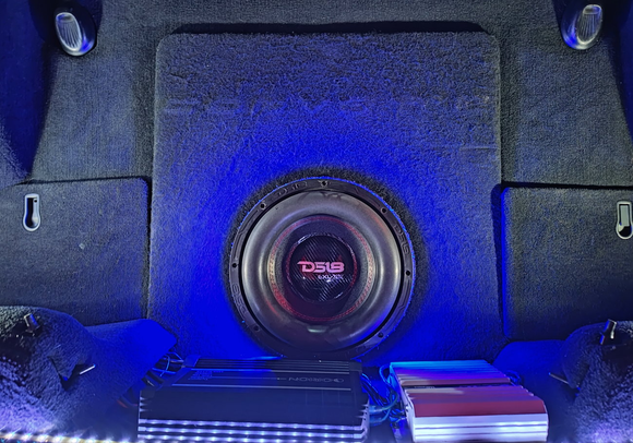

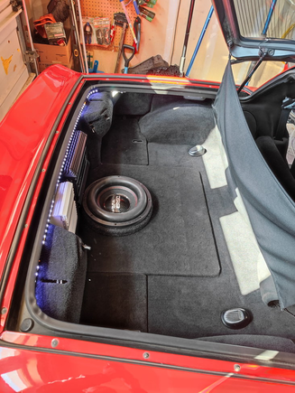

the sealed subthump box i use in the center cubby is 1.1CF so it's plenty roomy for the specs of both the subs you've listed.
