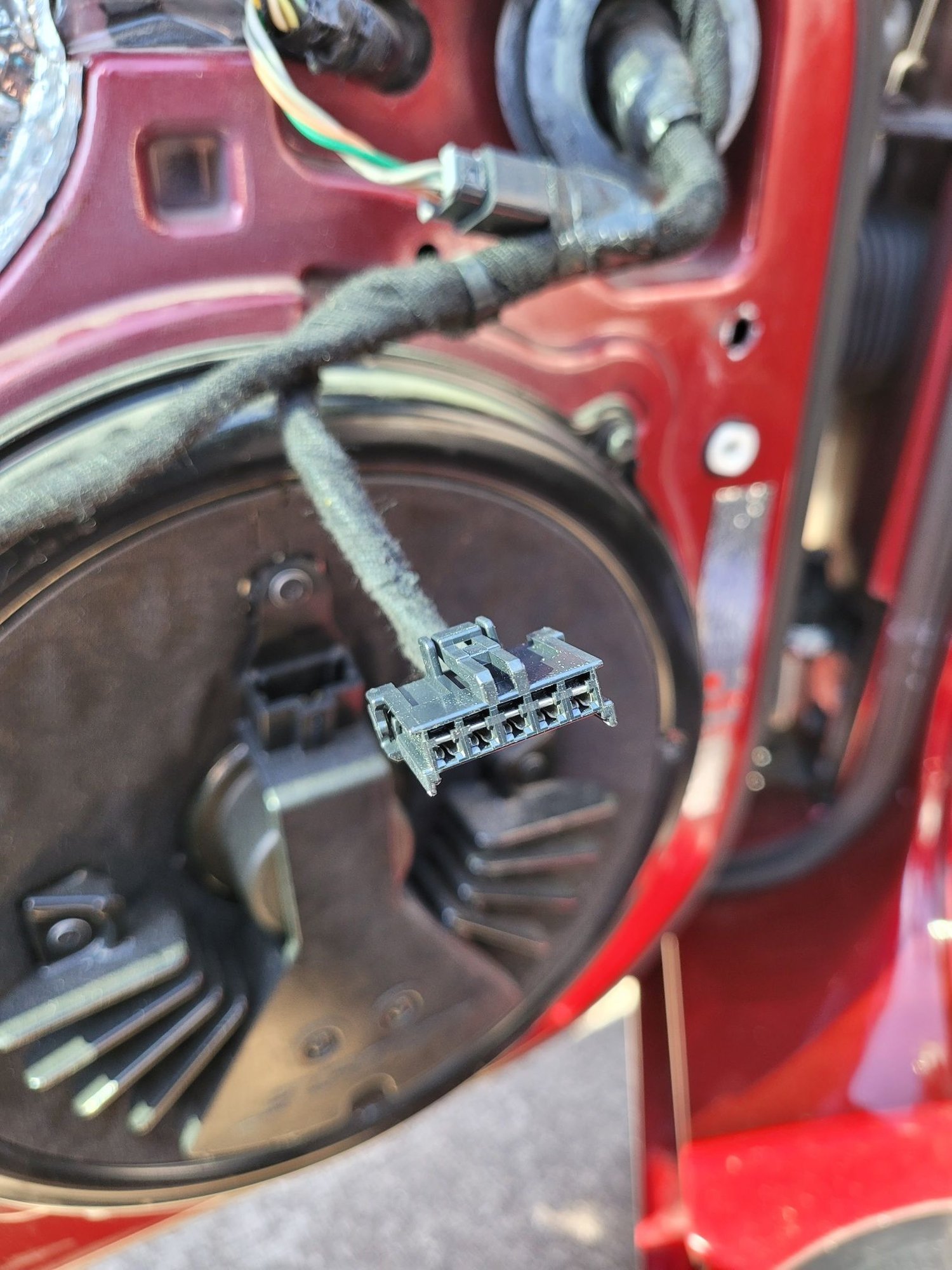

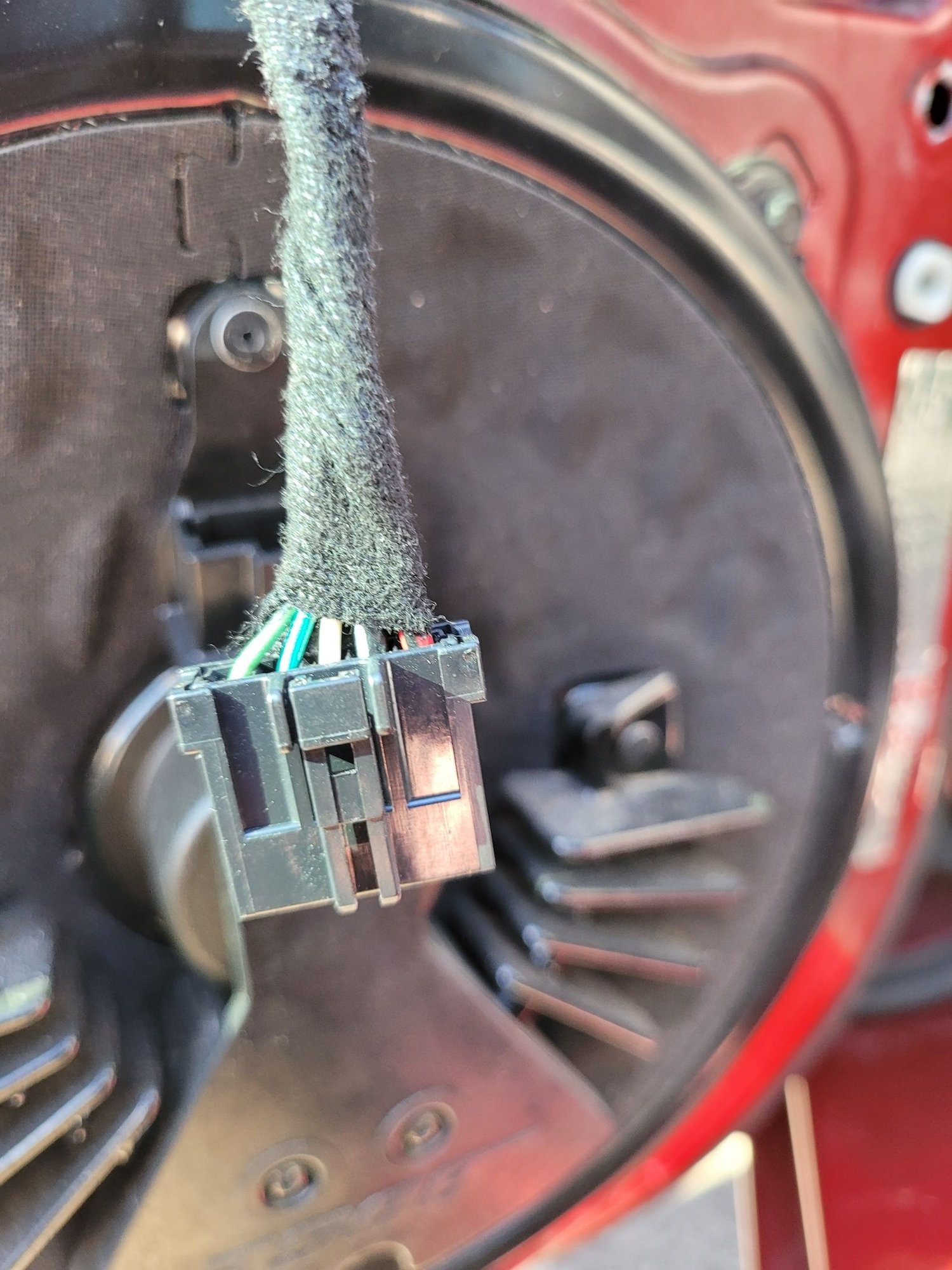

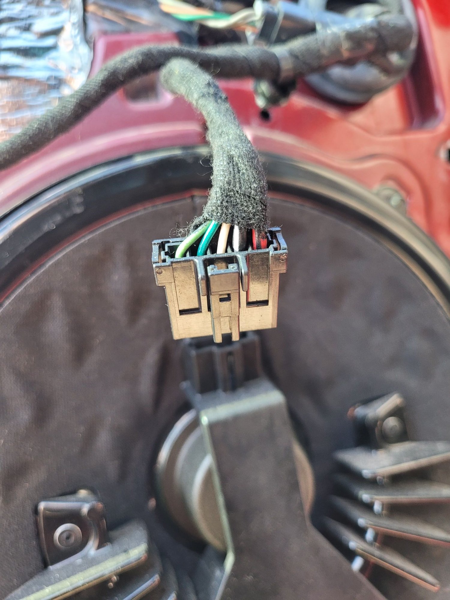

I need help Please. This is the plug to my 2007 C6 Bose Base speakers in the door. I need to find an adapter plug, or instructions on which color wire to use to connect too, to install a new set of Kicker speakers. I cannot find any references to this plug.

It's not that simple. Your model has the amp built in, so any replacement will need to include a new amplifier.
IMHO, you should start upgrading at the head unit.
